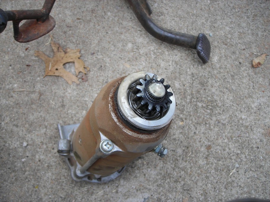

                  As you can probably guess, I found this stuff while working on my starter. Now I'll have to go up through the rest of the airways and get it out. Guess a winter full of 2 mile rides will do this to a bike. Questions:

                            hi draketrumpet
                            thats one rusty looking starter motor,
                            did u pull that out of the engine like that?
                            or has it been sitting outside?
                            id definately be changing ur oil.

                              Originally posted by petejw
                              hi draketrumpet
                              Haha, no that is not rust, but yes I pulled it out of the engine like that. With the starter, you may recall, that most of it is just under a plastic cover, and only the end with the gears are in the engine.
                              What you see as rust is Oklahoma dirt...it's everywhere.
