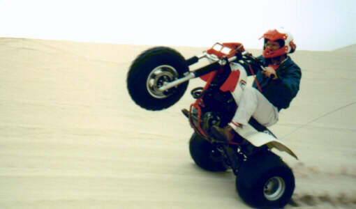

I was just thinking back to my younger days tearing ass across the countryside in a foot of snow on a 1986 Honda 350x.....
This guy I used to work for had 4 of 'em -- 2 85's and 2 86's. I lived on those things for 3 years. They were perfect farm vehicles - you could cruise wide open down a gravel road/highway at 70mph with no problem. They did about as good as most 4WD 4-wheelers in the mud. They were also light enough that I could load one up in the back of a pickup truck without using ramps (lift front end up and set in, then use the weelie bar to lift the back up and in). I had so much fun on those things. Man I used to beat the hell out of 'em too - seemed like you couldnt' hurt 'em.
I WANT ONE!!!!
