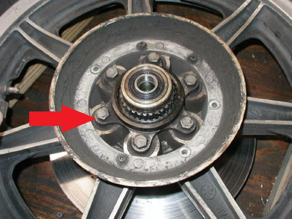

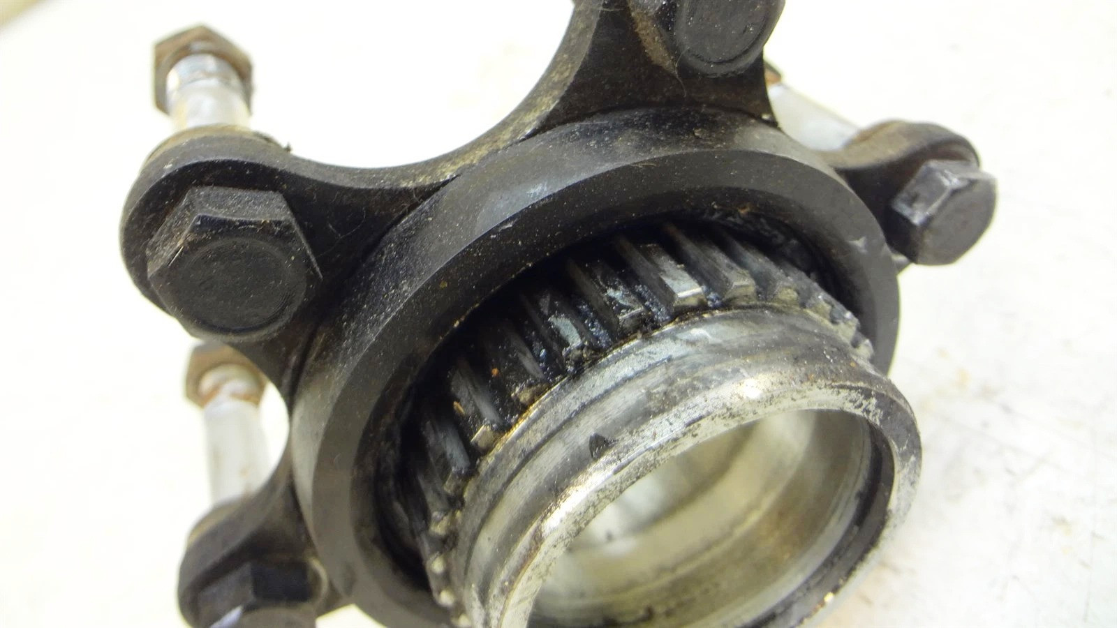

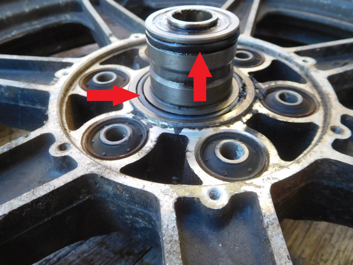

    And if you shim here, the big O-ring will not cushion the splines. Can't do that.

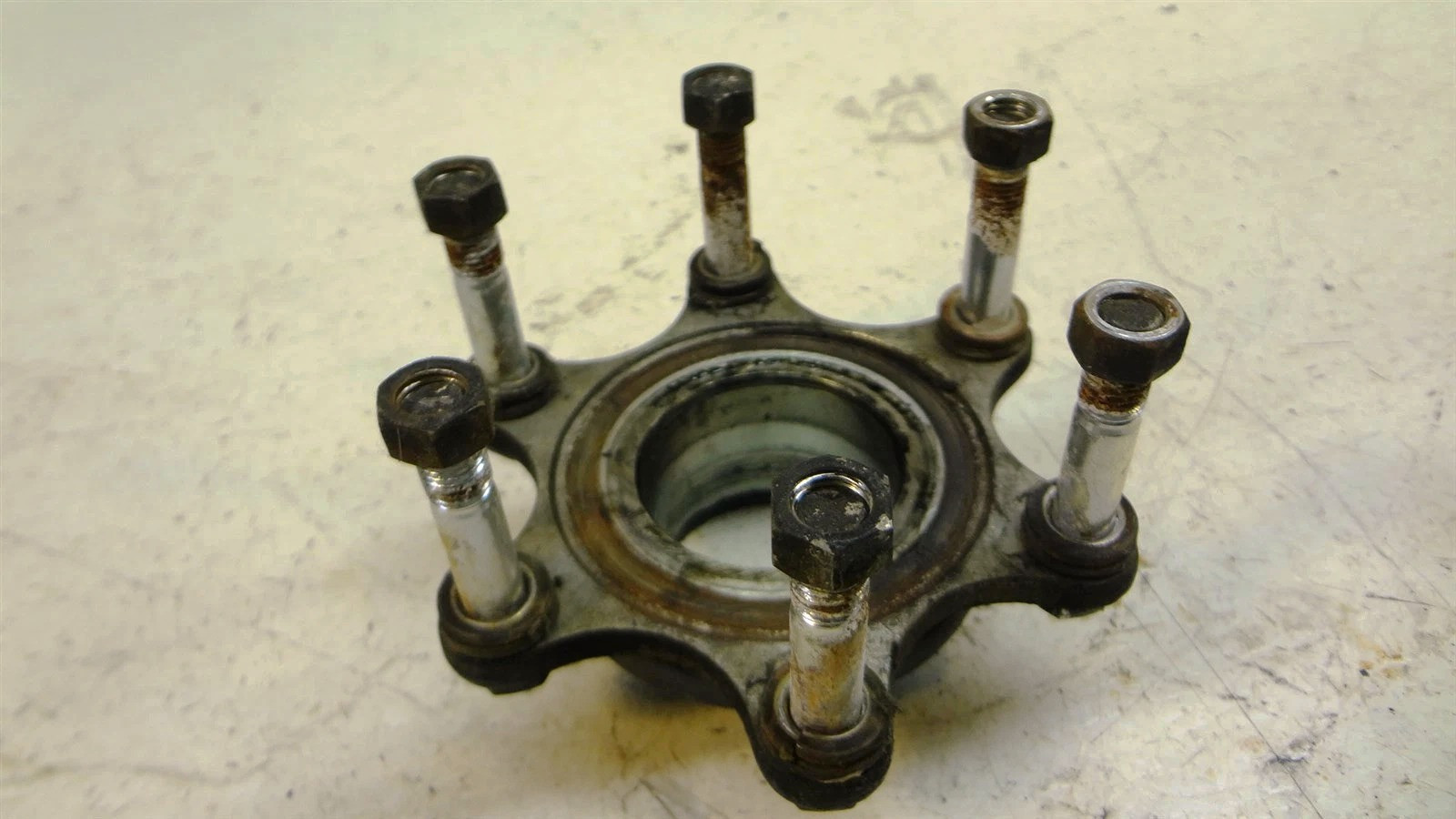

      • 1920
      Lots of issues to deal with.

        • 8847
        Yeah, it does look like a lot more is involved. Would also need to shim the center and remove the same thickness from the outside of the hub. The ideal way would be to make a one piece spacer plate 2mm thick to fit against the wheel. Also, the fitment of the axle would probably be an issue. It may be easier to notch and reweld the swingarm after all.
