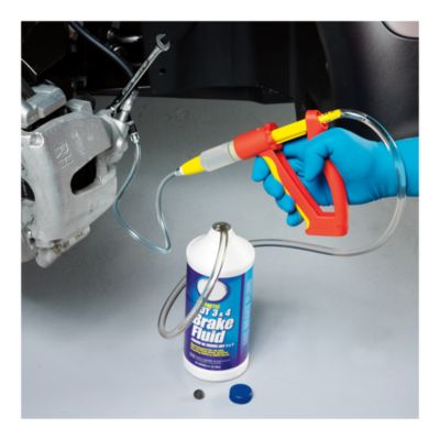

                      As we all know, air rises, so while your pumping the air bubbles down, as soon as you let go of the lever where do the bubbles go, up.... I used one of these last time I rebuilt the master cylinder and both calipers. It was the quickest way to get rid of the hard to get bubbles since they are up high by the master cylinder anyways.... I just primed the lines with the master and bled the calipers first, then hooked it up and did the reverse bleed on the rest.
