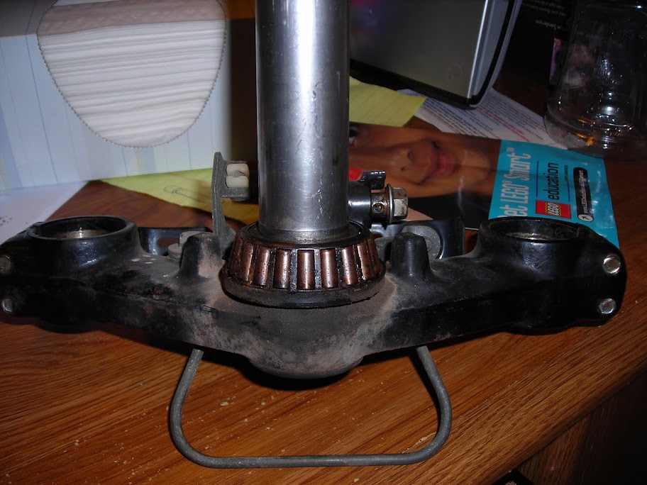

          Hammer and not-quite-as-fat-as-I-would-have-liked-flat head got it out without too much scarring. I've got tapered bearings as you can see, so I believe they've been replaced sometime in the past, however, whoever last adjusted them had a rather blunt way of doing it. The cap is slightly bent because the nuts were screwed on so tight.
          Anyway, now to clean them. There's a bit of rust from the frame dohickey that holds the bearings in place, but nothing on the bearins themselves that I can see. I heard somewhere that I can spray them with brake cleaner. Can someone confirm this. I'll do that and rub with a copper brush if no one says that's a bad idea. Than slather them up with plenty of grease and tighten them down.

          Also, does anyone know what that white plastic think in that little bracket to the left of the bearing is for? Nothing was attached to it.

            Bracket is the headlight stay. An adjustment bolt goes through it to the headlight to adjust vertical aim.

              That would explain why there was nothing there. Thanks.
              Any opinion on brake cleaner & brass brush v. dirty bearings?

                I think it would work fine, just be sure it's completely gone and can't contaminate the grease before you re grease it and put it back together.

                  Originally posted by draketrumpet
                  I've got tapered bearings as you can see, so I believe they've been replaced sometime in the past,....
                  Is there any other type ??? I've never seen anything other than tapered bearings in a steering head.
                  Maybe it's just me but personally, for the few bucks they cost, I wouldn't even consider tearing it down to that level without replacing the bearings. The rollers themselves may look okay but what you cant see is the condition of the race underneath them, and while it might be fine, it might not be also. It's not a hard job and once done you then know with absolute certainty that they're not going to be a problem for quite some time.
                  And FWIW I made a "C" spanner for those nuts out of an old metal shelf bracket, you know the type, often seen in harware stores holding shelves and wall brackets up. About 3mm thick, about 200mm (8 inches) long, roughly triagular in shape and two little hooks at one end to hang of uprights screwed to the wall. With a hole saw, hacksaw and a file I fashioned one into a workable C spanner that has had numerous uses over the years. It don't look pretty but it works.
                      If you look at the manual, you'll see the original bearings in there were regular ball bearings, and there was no kind of seal or cap under the bottom bearing. Now-a-days tapered are the only kind sold, but if someone has a pure stocker, it would, I believe, have normal balls in there.
                      As to replacing the bearings, right now I'll be lucky if I can even get the bottom one off of the stem since they were put on so darned tight.

                          My top bearing is marked "Koyo Hi-Cap 32005JP"
                          Rasputin, are yours all the same or similar?
                          Looks like I'm punchin' the pay button on some all balls no matter what. The bearings were so tight that the outer races have permanent indents and scratches from some of the balls.
                          Now, if I only had a way to get that bottom bearing off of the stem...maybe I'll stop by the local shop and have him pull it...hmmm
                            All balls are good quality. The races will come out with a drift bent to a slight angle. I've never seen the roller type bearing on one of these bikes ever.
