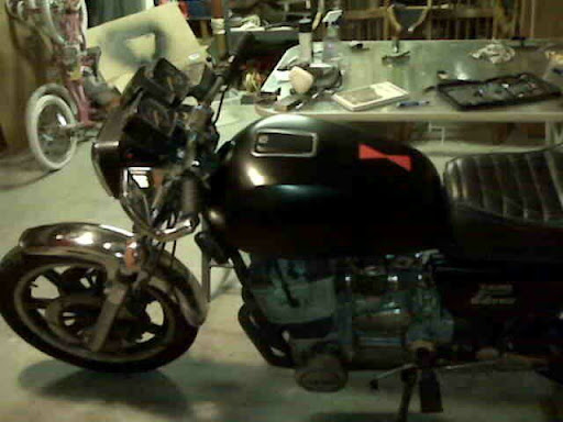

                Looks like I just needed to use the IMG coding. There you have it, my XS11 with a new Black Widow paint job. Mayhap I'll add some spiderwebs soon.

                        Another Frankenbike?
                        Hi Cody,
                        if your bike is a '78 it has to be a Standard because the first Special was a '79.
                        BUT
                        Although the photo shows the big gas tank, rectangular gauges and rectangular headlight that's right for a Standard;
                        the slotted brake rotors and axle-on-the-front forks with the Weird Harold brake calipers are from an '80 or newer Special.
                        What you should check is, which triple trees you have.
                        Standard 'trees + Special forks reduces the steering trail.
                        Which is great to reduce steering effort on a sidecar rig but can make the solo ride a mite skittish.

                          pretty good observation there Fred
                          Note that the bike has the "one piece handle bar holder" which happens to fit standards only so he's got standard triple trees and most likely 81 special forks. The timing cover... which was used in 81.
                            mro
                            Hi mro,
                            what with my elderly eyesight and the blurry photo I didn't notice the one-piece bar clamp and I can't see if the bike has square or round front signals either.
                            Thing is, I swapped Standard 'trees into my Special on purpose to lighten the steering for sidecar use.
                            I have mentioned that this modification would also alter a bike's solo ride but I do wonder how radical the change would be.
                            Cody, a ride report please?
                            Fred Hill, S'toon
                            "The Flying Pumpkin"
                              • 8930
                              I've tried Special forks in Standard trees for a while. It's fine 'till you hit the highway, then the bike is all over the place. Feel's like it wants to tank slap.
