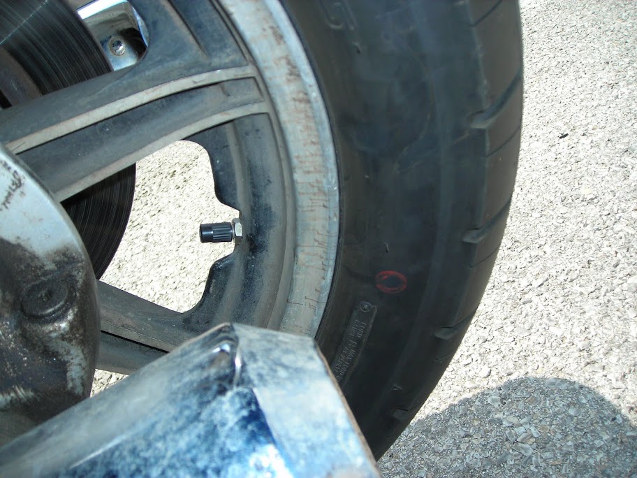

        Congrats! Now, if you'll look at the Tire Change pictorial, you'll see an example of the bead line/marker that is on the sidewall of the tire and you'll want to look closely at your new tire to make sure that it's present and in the proper position all the way around both sides!! IF not, then the bead isn't seated right, and that could explain the sideways wobble in the tire you saw!?

            Is this the colored dot you're talking about TC?
            It's inline with the stem, even though this angle doesn't show. Neither of my manuals seemed to have a diagram of that particular aspect of a tire change (both available on cBug's page), but they mentioned a colored mark, I just thought it was going to be on the bead itself where I couldn't see it anymore.

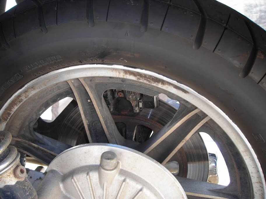

            Or wait, are you talking about like a little rubber line that looks like its leftover from "casting" (for lack of a better word) the tire, like you can kinda see in this pic:
            I got a little confuse with the colored dot thing in the manual. If this is what you're talking about, I'll be sure to check it is in the same position on both sides tomorrow.

              I'm pretty sure TC was talking about that line.. the second thing you mentioned, not the colored dot. Sometimes, a tire will inflate all the way, but not be actually seated on the bead of the rim completely. Making sure you can see that bead line sticking out of the rim all the way around your tire on both sides... sometimes it likes to stay tucked in there a bit, and this would pull the tire a bit to one side at that point.

                Getting the tire to seat fully can be a pain in the butt! When I put a new front on my bike back in January, I could NOT get the tire fully seated (very apparent for how the bead line ducked under the rim for almost 6 inches around). I was finally able to get it all the way home with lube, 80 psi of pressure and a 5 lb mallet I used to whack on the tire next to the rim. It took several good whacks, but when it did seat, there was a nice "pop" and the bead fully seated.

                  So as best as I can tell, both tires are completely seated. That nifty line stays within 0-2mm of the rim all the way around. Could worn out bearings cause this as well? If so, another thing to look at during MOM.

                      So as best as I can tell, both tires are completely seated. That nifty line stays within 0-2mm of the rim all the way around...
                      In my mind, even a 2mm variation means that tire isn't fully seated. All the tires I ever mounted, that 'guide' line was dead-nuts the same all the way around.
