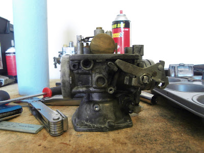

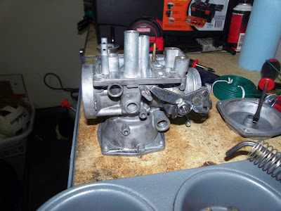

    So I finally found some time to tear down the carbs on my 79 Special. I bought an ultrasonic cleaner from Harbor Freight about a month ago to do this. I found information on here to use Simple Green, water and dish soap. I have to say this combination worked wonders.
    I tore the carbs all the way down and did a quick rinse and run over with a wire brush and carb cleaner to get heavy amounts of grunge off. I then ran the internal parts on 3 cycles (8 min each) and then the carb body 4 cycles because the entire carb body could not submerge, so I ran it twice on each side. I of course used the water heating function of the cleaner. After the cycles were done I rinsed all the parts in warm water to ensure the side affects of SG that I read about would not happen (corrosion).
    Before:
    During: (The steam adds a cool effect!!)
    After:
    I am taking my time to get these babies clean as possible so it is taking a while. I have got 2 done. I found what may be my issue with top end power loss, the slides were not sliding very well. I wet sanded the slides and the slide shaft with 400 then 800 grit sandpaper, now they fall like they are supposed to.
    Here is what I love about this method, my hands don't get eaten up by carb cleaner and I don't smell like it for days afterwards. My wife is happy about that part.

    Not too bad! If only we could just dunk the whole bike like that!

      Man, the outsides sure cleaned up nicely!
