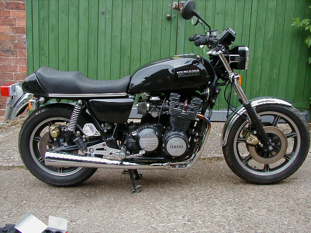

                    Searched a bit on the net, found this picture. This is what I have, so definitely a '79 XS1100. Mine is same colour, but spraying it Lancia Ebony Black (LEB 502, if I remember the paint mixture correctly) in the next few weeks. Also considering airbrushing the fuel tank top.
                    http://www.classicbikes.co.uk/images/xs1100blk01.jpg
                    Thanks for all the help sofar.
                      That one has aftermarket pipes, a rebuilt seat, pod filters, and the engine and brake calipers have been painted. I just remembered one other thing too - The '78 and '79 models had non-slotted brake rotors, like your picture. After that, they were slotted.
