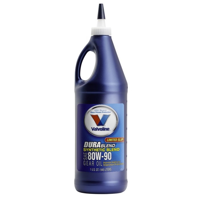

      • CatatonicBug
        • 6117
        • Clinton, UT
        This is the stuff I use.
