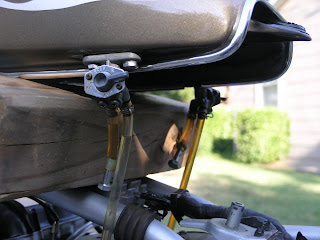

          Using Phil's suggestion, I routed mine as you see below. I have enough play in the line to lift the tank up on a 4x4 block. This way I can reach most of the parts I need to access. I can also hang the tank from the ceiling if I need more room. Bike bandit sent me three feet of yellow line instead of clear which accounts for the three "dirty" tubes. That will change when more cash flows my way.
          As always, I am open to any suggestions. The only trouble I had was making sure that there wasn't too much line so that the fuel lines contacted the hot engine. I am not sure, but I think that would be a bad idea.
