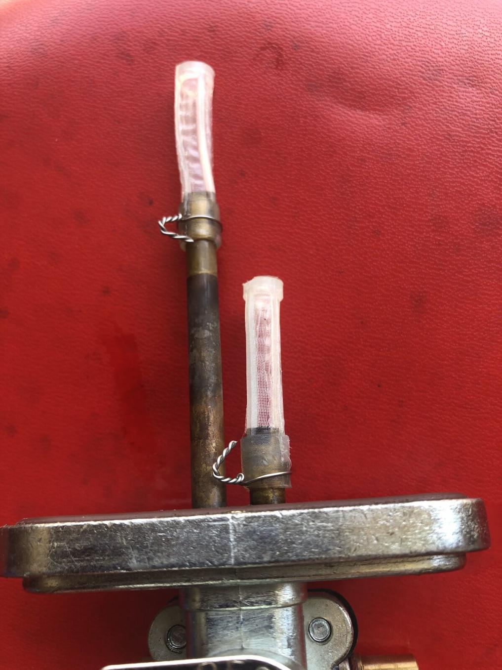

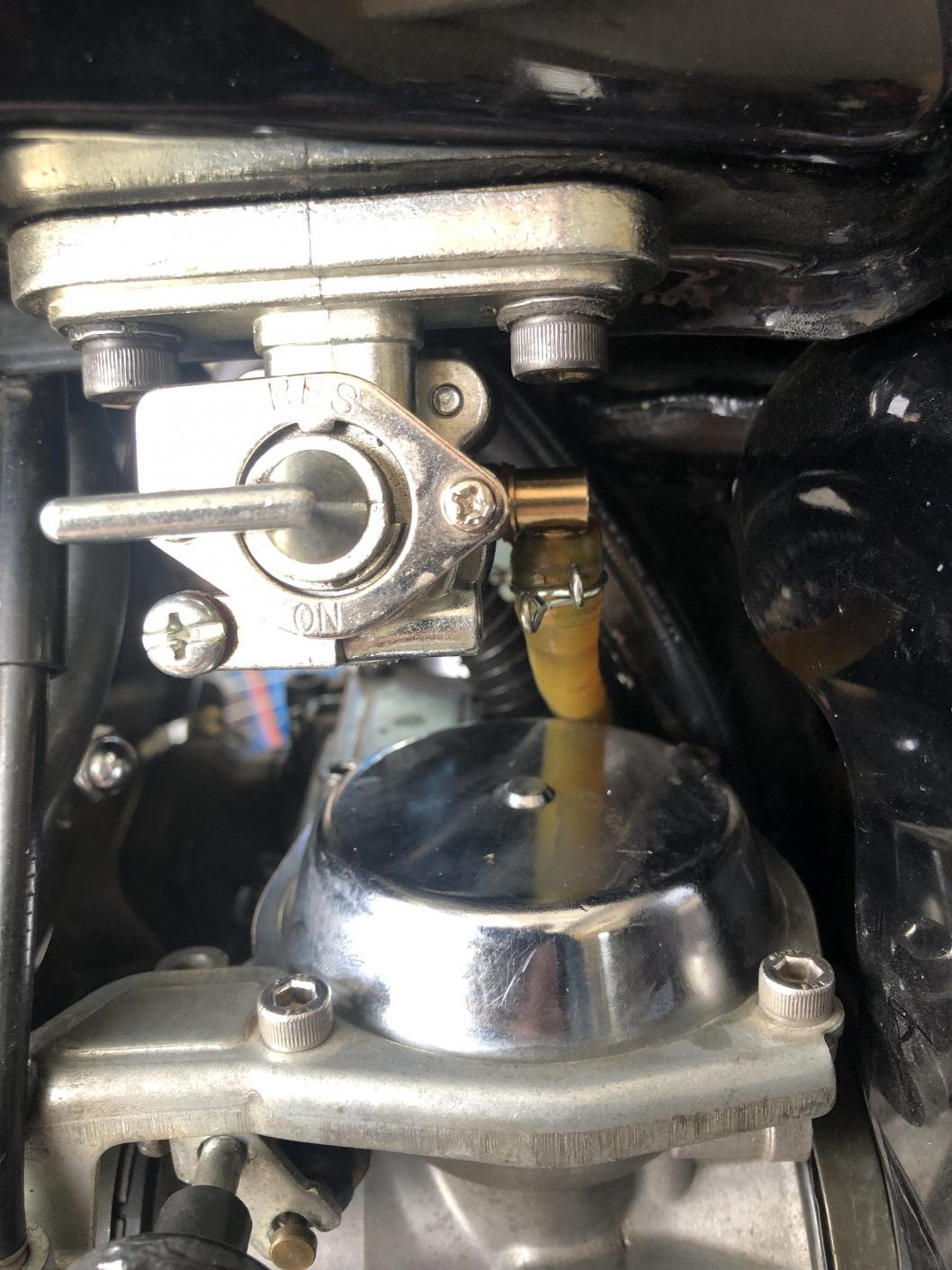

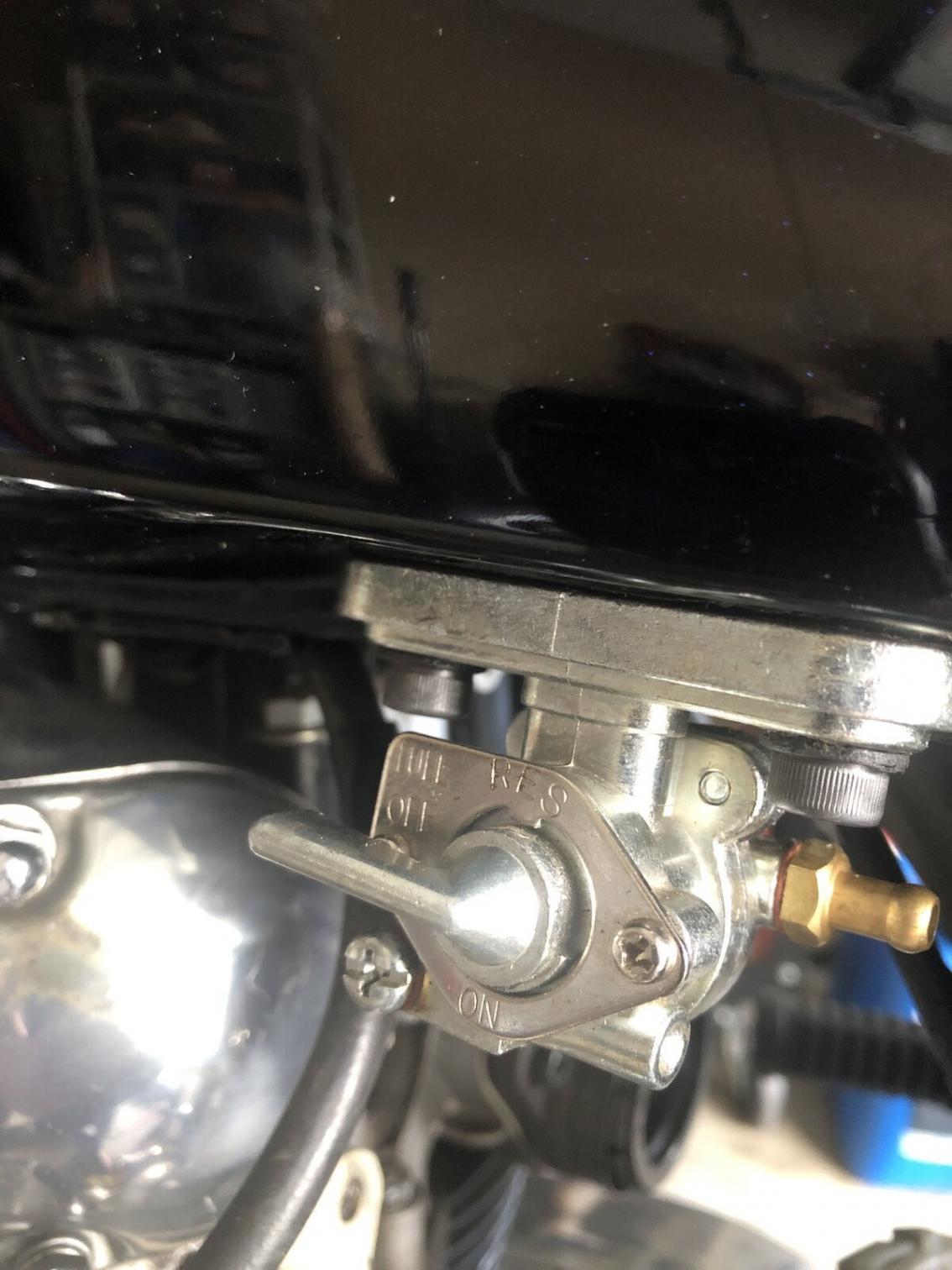

          DEEBS11, to your point, those are not plug 'n play. I installed one last spring. I had to buy a rebuild kit. The valve face had to be ground flat. I safety wired the screens on, so they wouldn't fall off. The outlet was 3/16 instead of the 1/4 I needed, so I had to deal with that. Oh, I had to source a 90 degree outlet, also 3/16 and shim it to the correct position. All more work than fixing the OEM petcock should be.
          Meanwhile, I bought a brand-new Yamaha over forty years ago. The vacuum petcock has never leaked or failed to open. I have complete confidence in it. The tank is full and off the bike as I send this. It isn't leaking.
          My Eleven Special retains its vacuum shutoff valve. I'll be repairing it soon. I acquired that bike in 2003 with 10K miles on it. Obviously, it did a lot of sitting.
            • 8073
            This shows the 90 degree fitting before shimming. I can't have the fuel line touching anything. Today, it doesn't touch anything and wears an OEM shroud. Also shown is my hillbilly line installation. There's a short piece of 3/16" Tygon with 1/4" tubing slid over it. Intent is still to go back to an OE vacuum tap. But, I did all this work!
Name:	Manual Petcock.JPG
            That's 0.020 aircraft grade stainless safety wire as reinforcement. The screens are known to be found floating in the tank.
