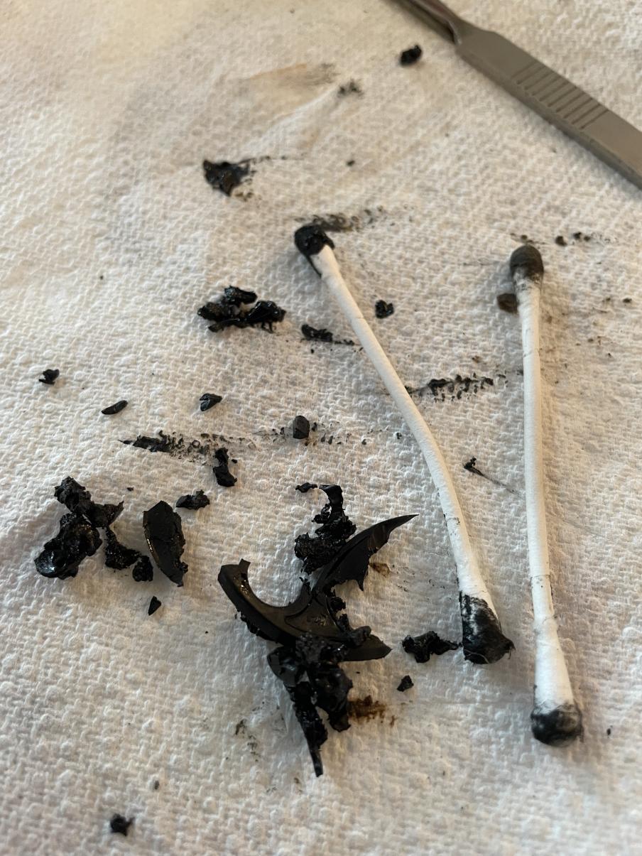

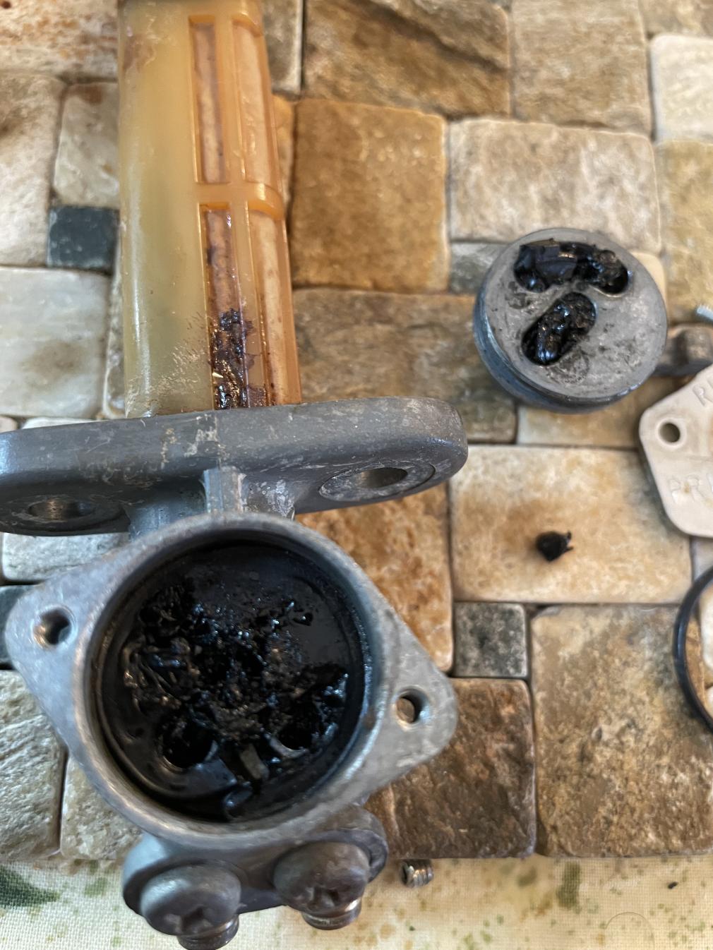

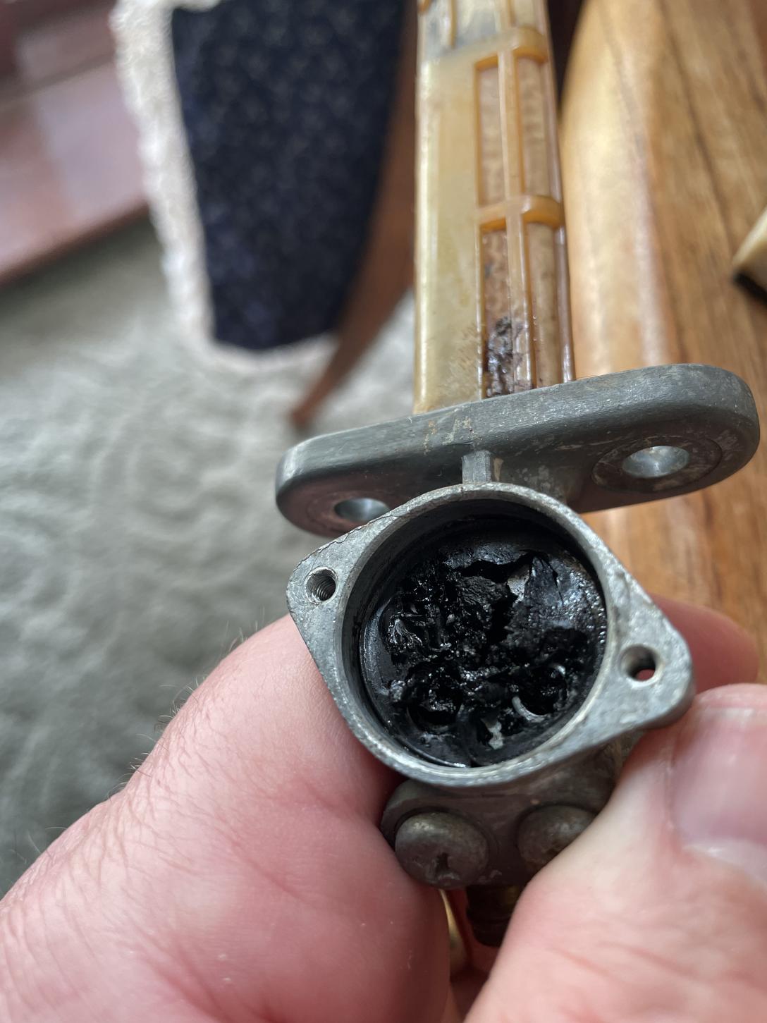

    Having stripped my petcocks now it isn't hard to see why they were seized up!

    EvelKeevil Hello there. Yes, that's a bad day.
    Bax
      • 1999
      It is amazing what you find when things sit for whoever knows how long. Like a science experiment. I have seen just as bad on many I have refurbed. I am sure all the orifices are all full of gunk too. If you haven't already make sure you remove the two screws on the bottom of the petcocks so that you have better access to clean the tunnels.
