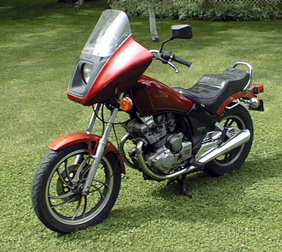

                  I had an '82 but there were major changes in '80 or '81 so it is quite a different bike from the '79. I had no problems riding interstates at 75 mph but the bike was really working at that speed, one of the reasons I moved up to the XJ.
                  Only issue I ever had was the oil pressure switch would get crud on it and short out the leads, turning the warning light on. Clean the switch and no more problems. Cleaning the switch top just became a regular maintenance item.
                  Missing badge on tank was replaced with a new one. Fairing was on it when I bought it, genuine Yamaha accessory but rare on a 400. Rear tire is same size as the XJ; 130 - 90 - 16. There was also a Seca version, different styling and a 6-speed transmission.
                  I sold the bike when I moved to Arizona in 2001, would not mind having another if I came across one. It handled well, was great on twisty roads where top end is not a factor, and was fun to ride.
