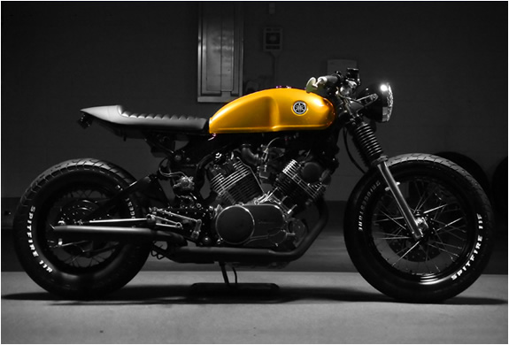

    Could be:
    • Diskman01
      • Mar 2011
      • 263
      • Sioux Falls, SD
      WOW. That looks awesome!
