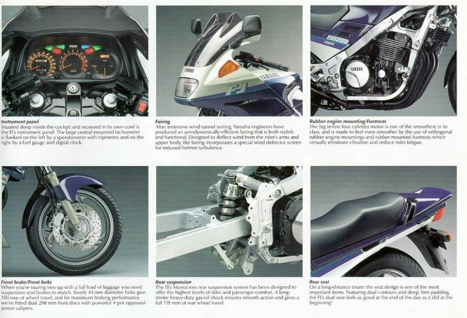

    I am contemplating using a FJ1200 mono shock (happen to have one) on an XS project bike. I have two questions:
    1) is the mono a linker or mounted directly between the frame and swing arm?
    2) can somebody post a picture?
    DZ

      Well, that answers most of my questions.
      Thanks

        that shock will work if the spring rate is above 650 lbs/in. I just used the R1 shock with an 800lb/in spring without the link system, very nice....if it would get above 50 degress here on a weekend, I can finish my project and get some pics up....looks like snow tonight again
