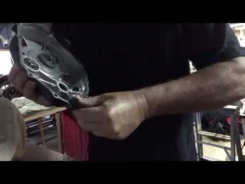

        All mating surfaces were prepped using this video as a guide-
        Imma thinkin' it made the difference between having to order/replace the gasket cuz of it sticking to the head or just an easy peasey on/off job (*_*)

          Just make sure you get the gasket surfaces clean as the video Larry attached shows. Failure to do so will result in a leak. I have never used any sealer but what Larry described as just between the cover and the gasket doesn't sound like a bad idea.
