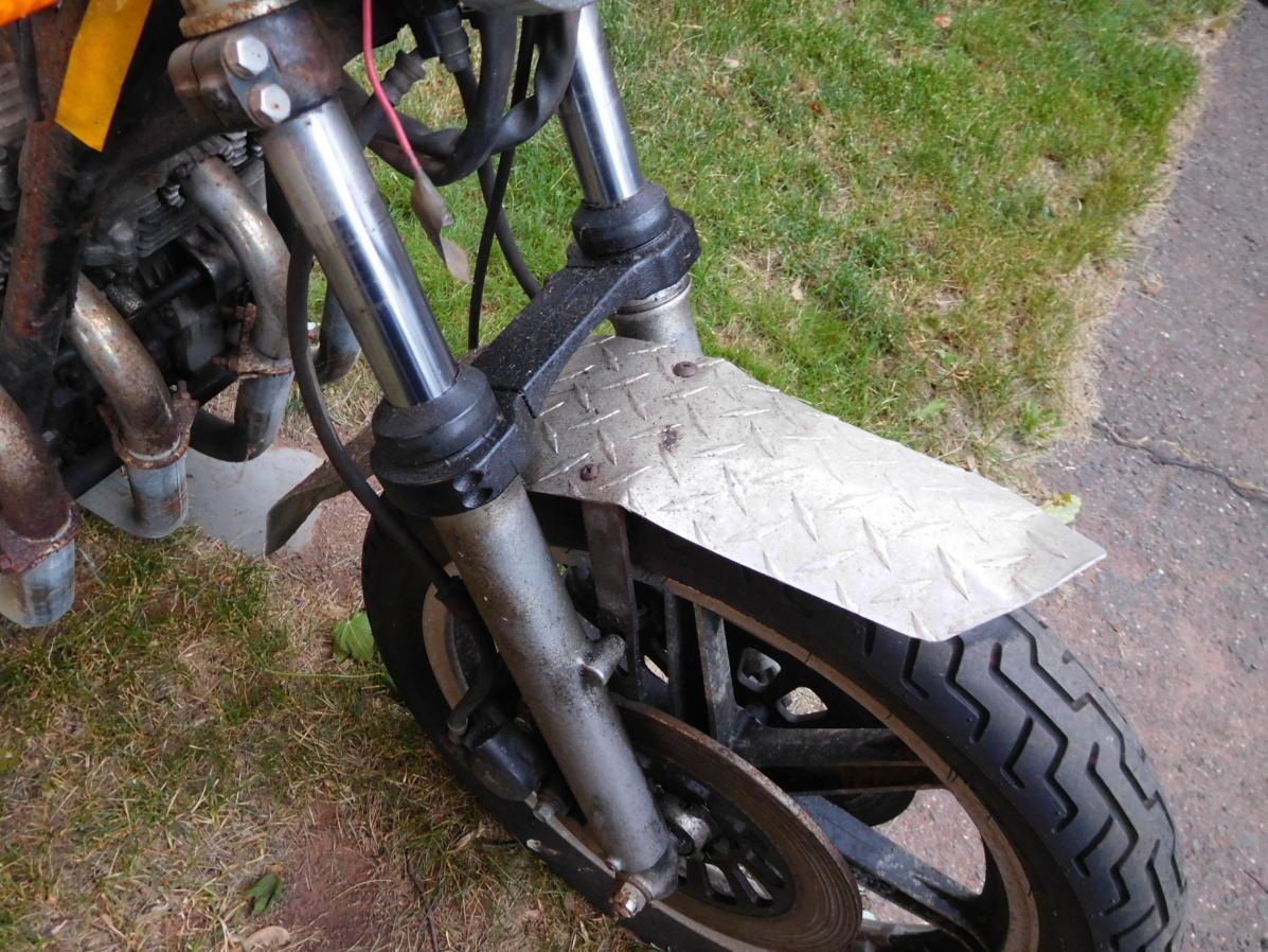

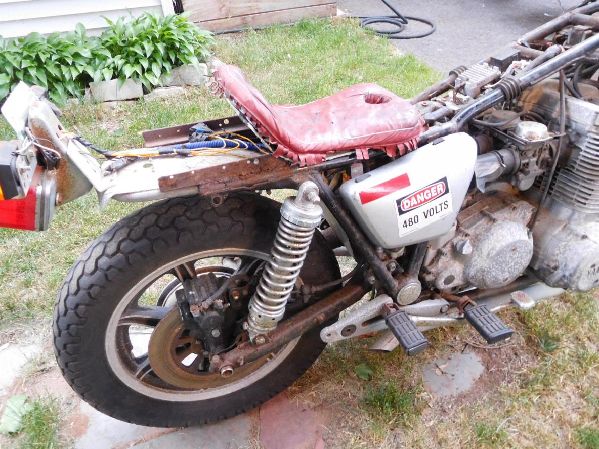

      Here is what a hacked bike can look like if you are not careful.

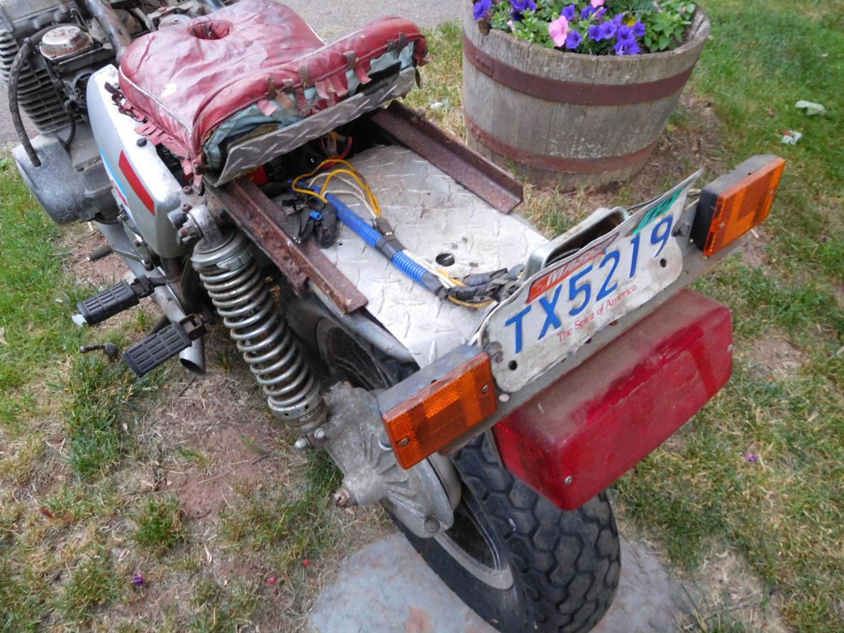

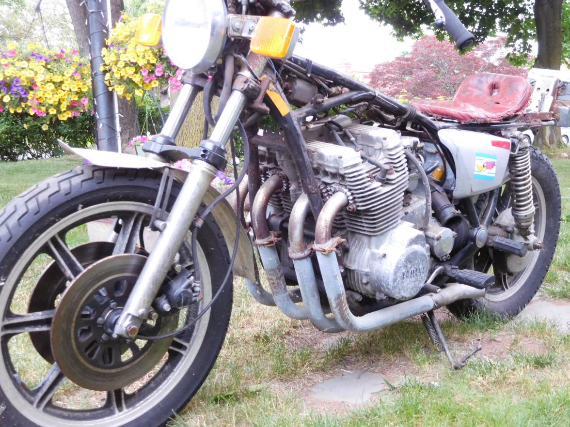

        Help preserve nature son.

          It's pretty cool how they used hay to shim up those exhaust pipes to make them fit!

                How is the only plastic left on the bike the only things I need for mine? Don't worry, I'm a machinist not a methhead.

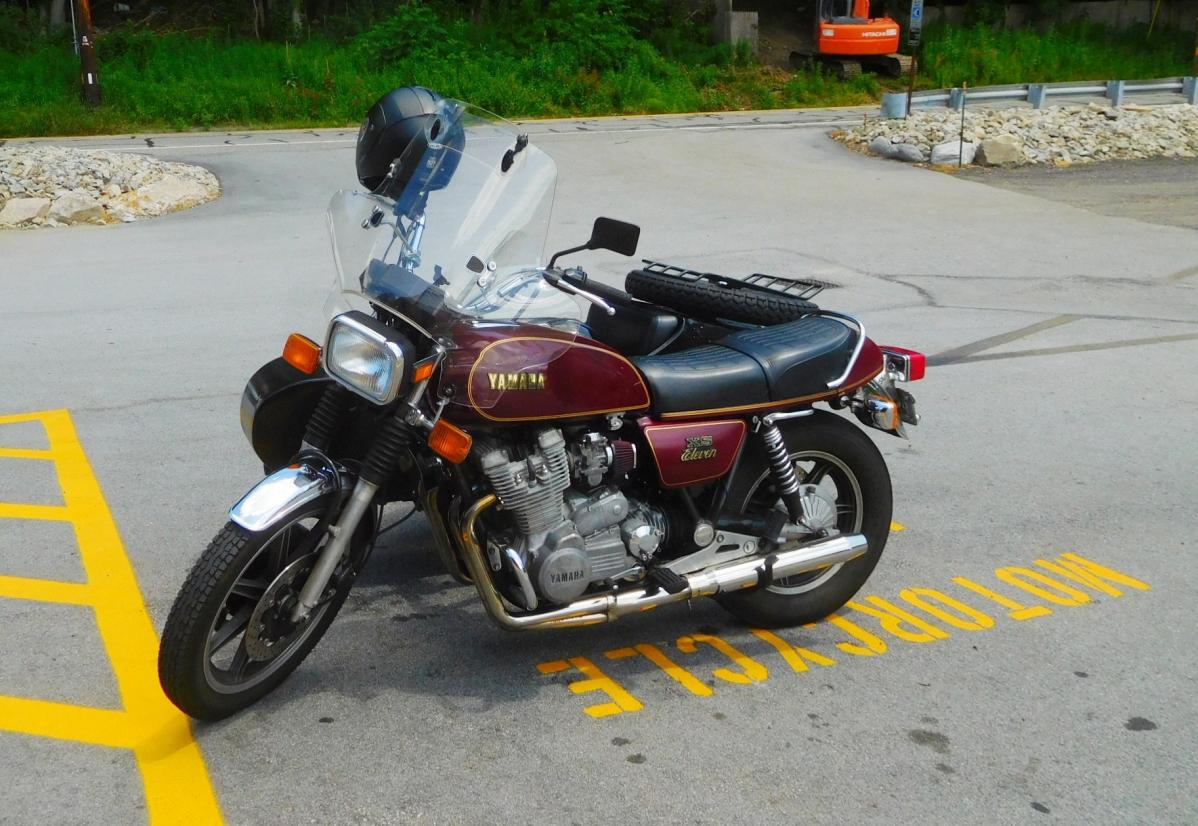

                  Hi PBN, keep in mind the plastic side covers on the Methbike are for a different year/model. Yours is like mine, 78. These are the correct units for 78.
                  Click image for larger version  Name:	DSCN3900A.jpg Views:	0 Size:	200.8 KB ID:	881125 Click image for larger version  Name:	DSCN2746A.JPG Views:	0 Size:	198.0 KB ID:	881126

                      Also, as a Standard, the side covers will fit 1978 through 1981. The 1982 may also fit, but I'm not positive on that. Anything can be painter, so color is not an issue.

                        I bought a 78 right side cover for my standard and it did not fit. The slots that go into the hangers are in a different position and even if you modify those slots the peg that secures the bottom is in the wrong spot plus the frame cutout along the bottom edge won't line up.
                          • 8938
                          Yeah, the 78-79 Standard side covers are different than the 80-81.
