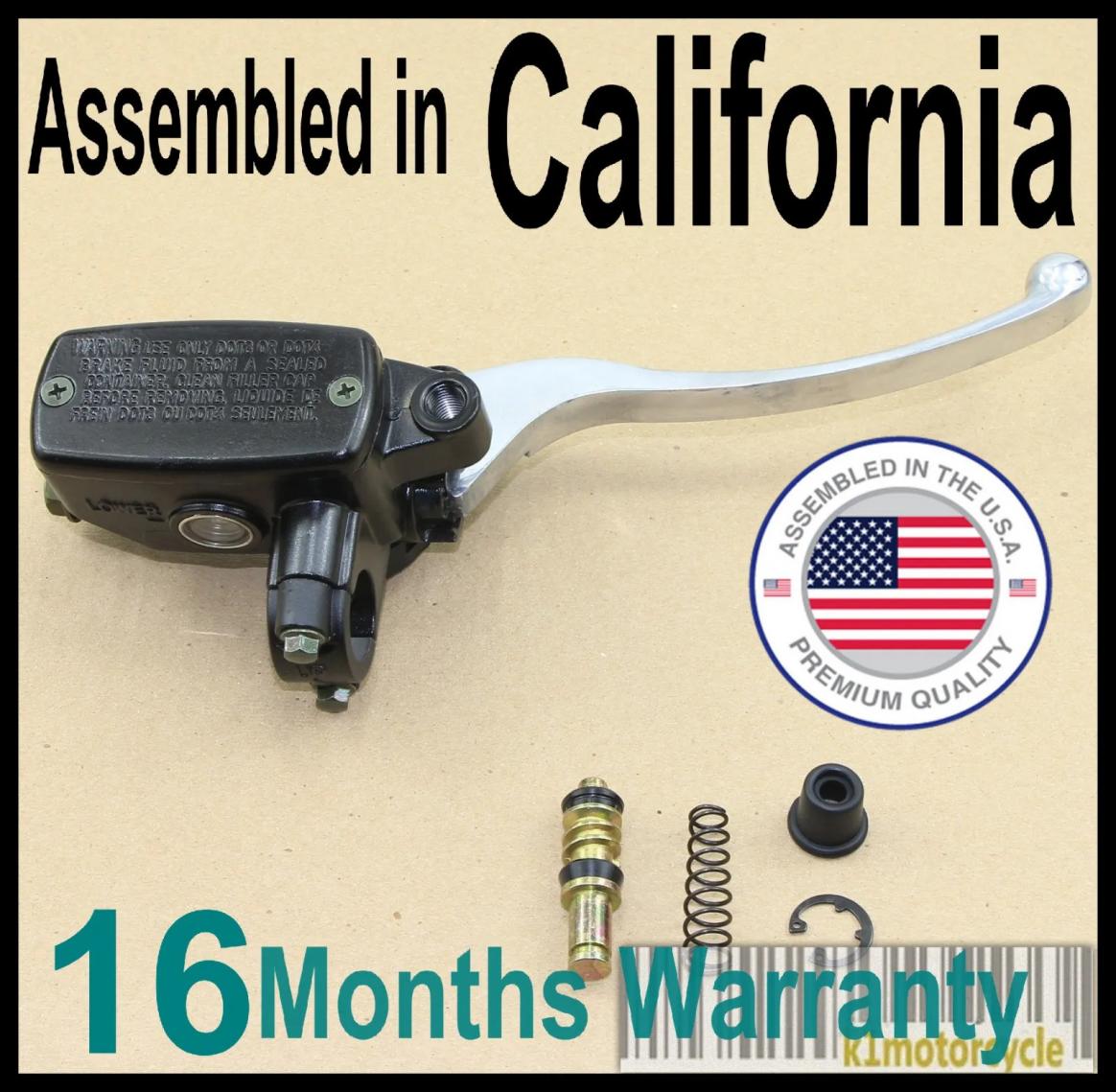

    • 2057
    You need 16MM for dual disk brakes. These work great and are economical. I have run these master cylinders over 50,000 miles on a few different bikes.
    https://www.ebay.com/itm/295232081050

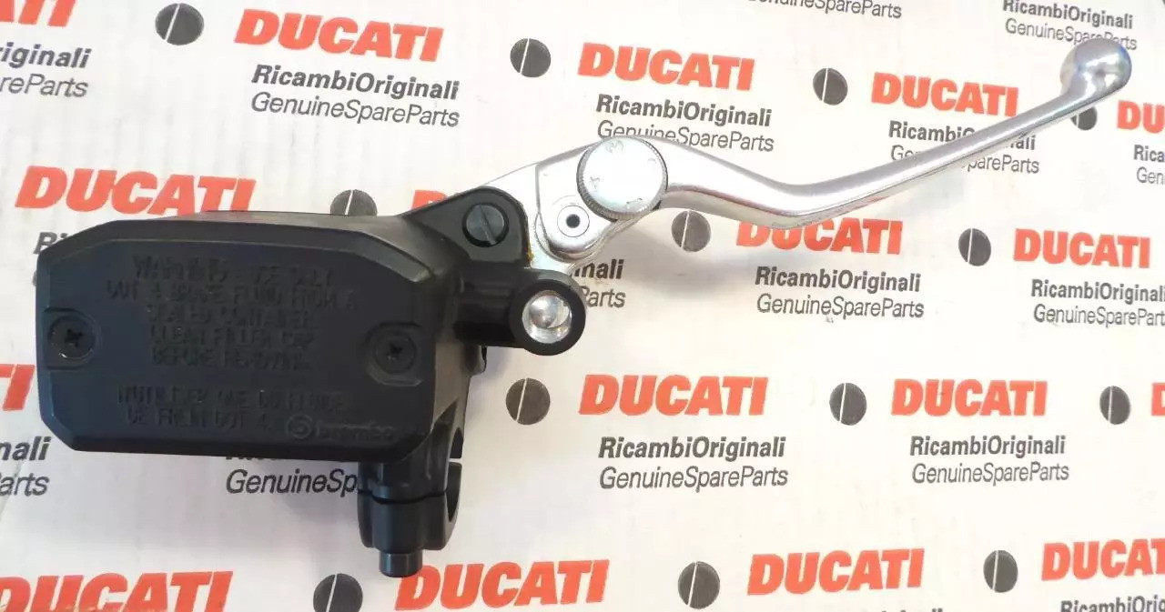

      • 2057
      However, if you want the finest quality and have the money, Brembo is the best you can buy. I am now currently running one of these on my XS11/sidecar unit. Both the economy and Brembo master cylinders perform the same. The Brembo fit and finish is better quality.

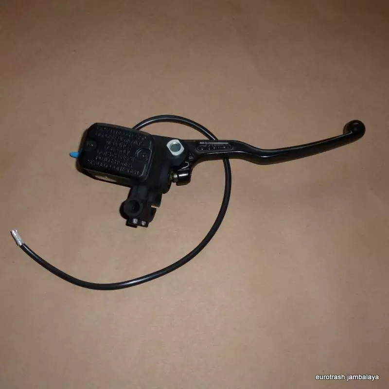

                    • 2057
                    The thing i don't like about some of those units is there is no lever adjustment screw to adjust the travel and dial in the "feel".
                    Like this?
                    https://www.ebay.com/itm/166858045860

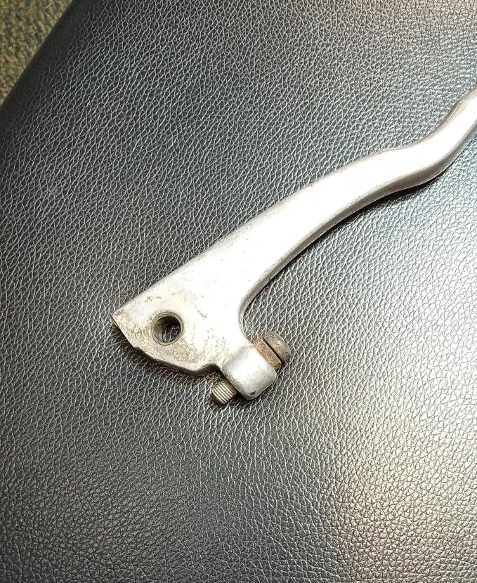

                        • 8928
                        No, this adjustment.... And the levers are not interchangeable.

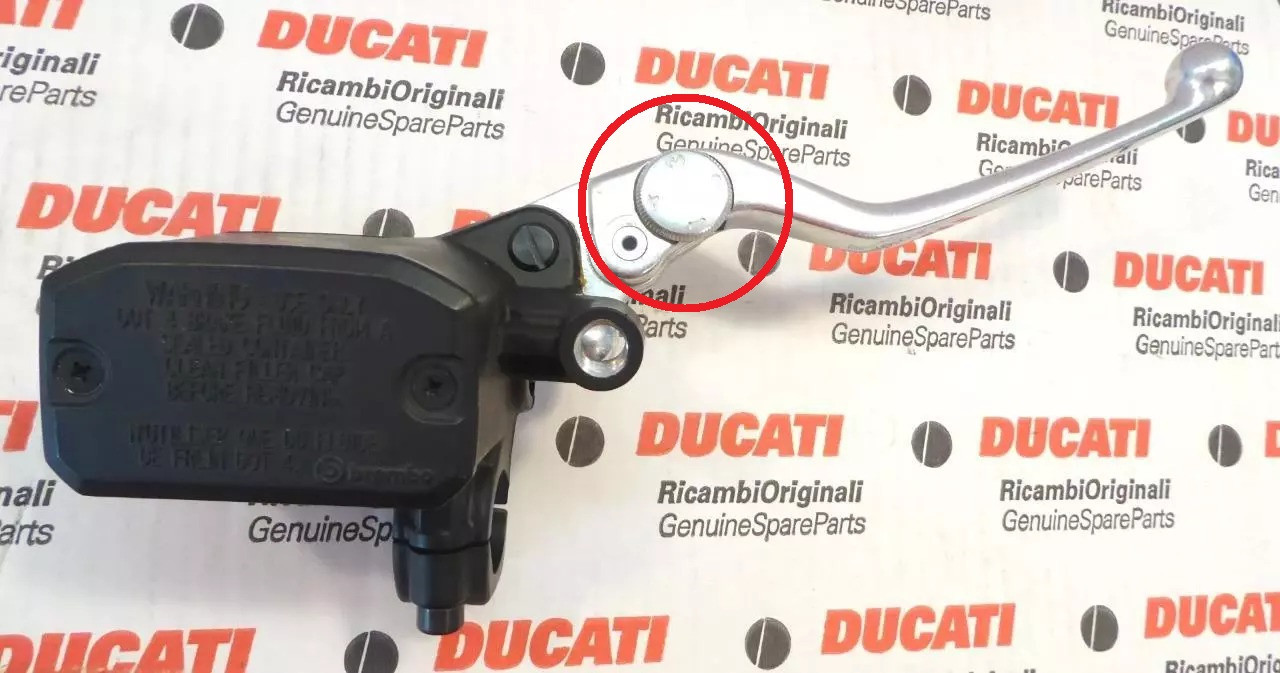

                          Understood. However, both types of adjustments are for grip to lever distance. The Brembo unit is bulky looking in comparison.
ID:	880838 Click image for larger version
Name:	Brembo adjustment.jpg
