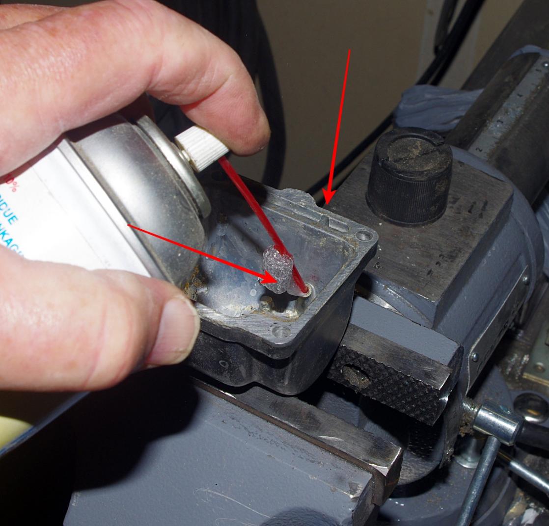

      Are you using the choke (enricher)?
      There are choke (enricher) passages built into the bottom of the float bowl that are the fuel supply for the choke. These passages get clogged. Have you sprayed choke cleaner through these passages to be sure they are open?

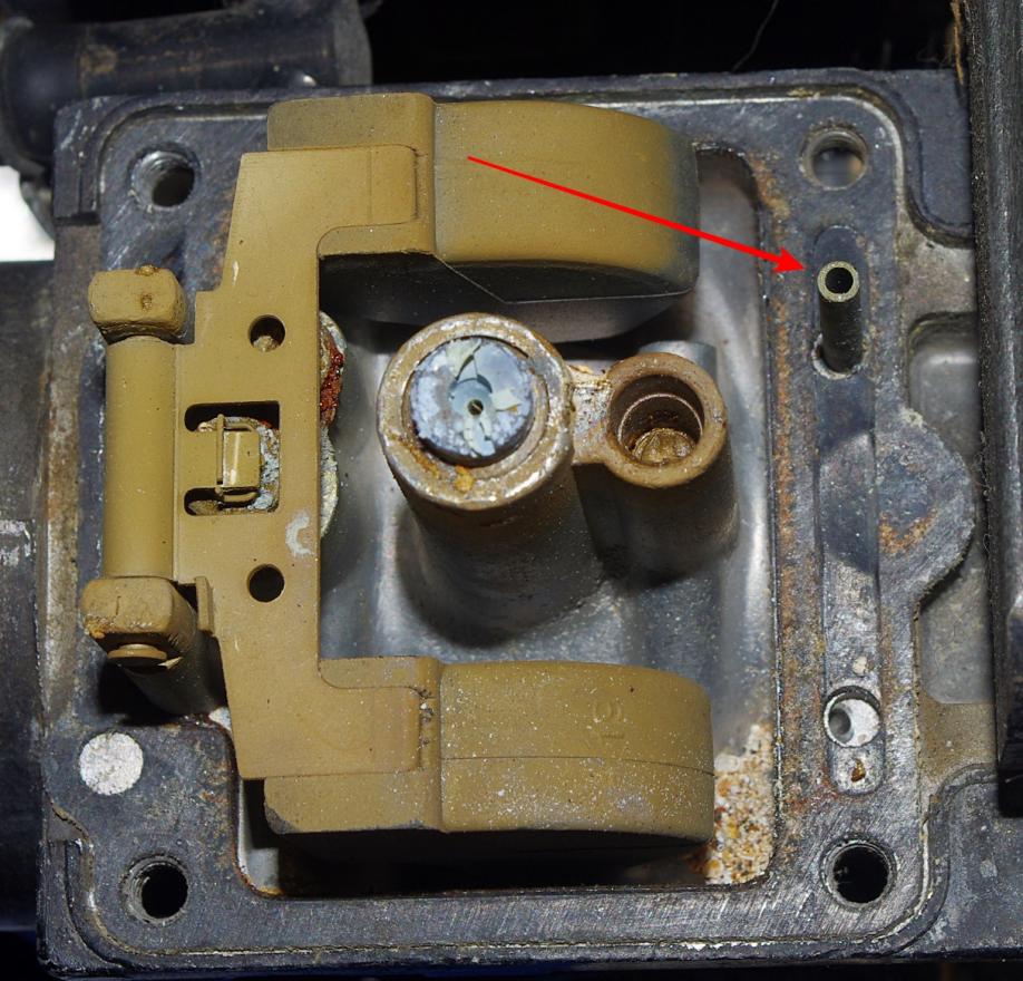

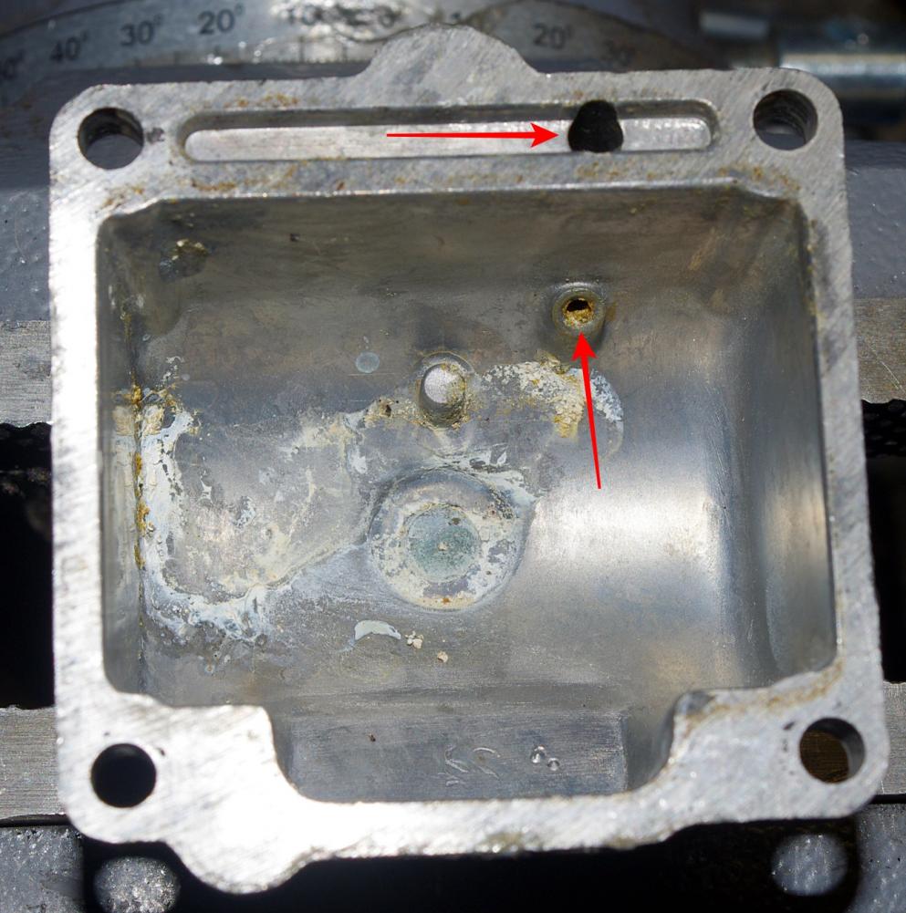

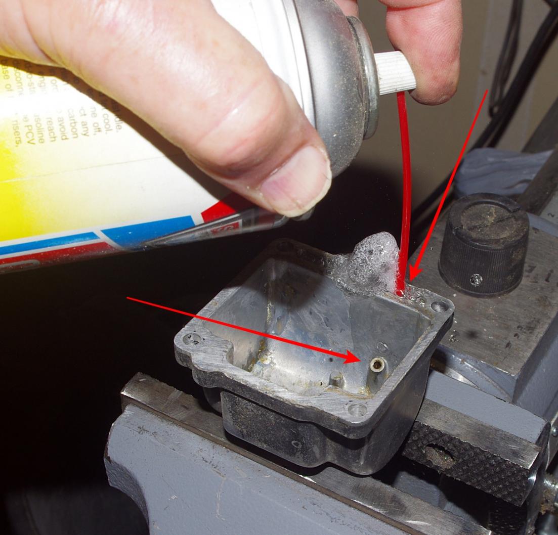

        Thank you. Any way you could post a picture of what passage you’re talking about- choke enricher passage.
          • 7835
          Here are a few pictures. Old, dirty carbs with a plugged passage. Notice that the carb cleaner is NOT going from the jet in the bottom of the bowl to the passage into the enrichment circuit.

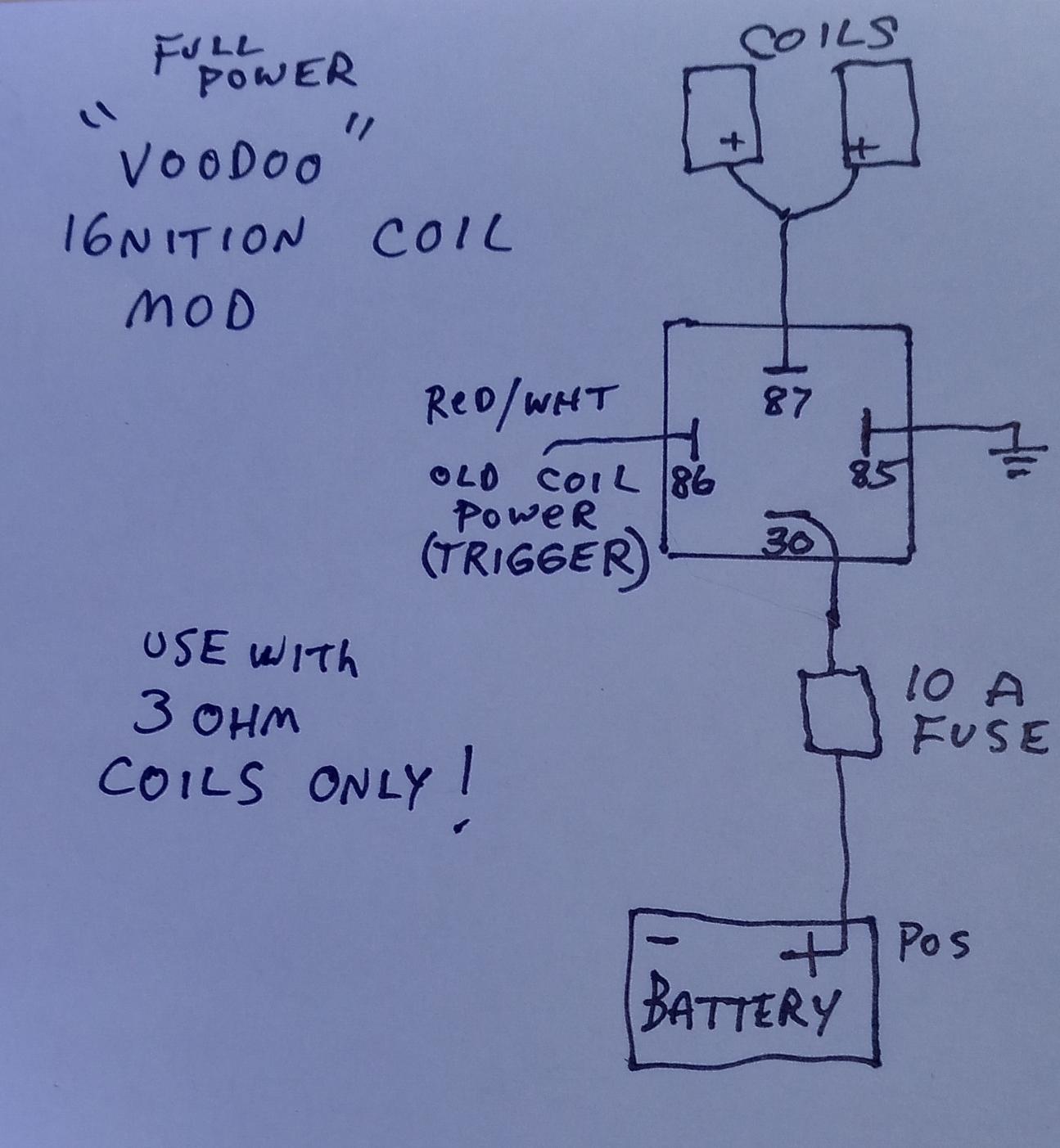

                        This is a very common problem with Yamaha motorcycles of this vintage. It’s low voltage to the coils with a cold engine and the starter engaged. I have a 1983 XS650 with the same issue. In fact, it won’t cold start at all with the electric leg. Fortunately, it is fitted with a kickstarter and usually starts on the first or second kick if I hold my mouth right. Do you have the kick lever for this bike? You can use it to prove my theory. My XS650SK starts just fine with the electric leg after it’s warmed up. I also rebuilt my starter. No change.
                        A friend of mine fixed the issue with a relay. It’s grounded through the kill switch. It puts battery voltage directly to the coils. This is an XS750 with the exact symptoms described here.
                            There was a guy at a parts swap selling little relays to put volts direct to the coils. Look up "XS1100 Coil Relay mod". Could help you out. My bike is running well, and I am nervous to cut into the wiring harness... so have not installed yet. Had to buy it though. 20 bucks to support a dude who is trying to support XS bikes seems like money well spent.
                              • 8934
                              Here is a simple mod for full power coil voltage using a standard 4 pin Bosch relay...
                              Click image for larger version  Name:	IMG_20240715_222224~2.jpg Views:	0 Size:	126.5 KB ID:	880759
