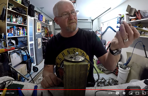

                      • 2001
                      Originally posted by JonnyO
                      Yep. You're right-thermistor bad. Now what? Can it be replaced/repaired?
                      Yes, Andy shows how to do it. BTW, watch the film carefully. When he goes to de-solder the thermistor, it just falls off. This is more than likely the problem with the circuit. He should have measured the thermistor for the 15K ohms at that point just to make sure the component was truly faulty. Might have been a simple cracked solder joint - a very common problem in a vibrating motorcycle with changing environmental temperatures.
