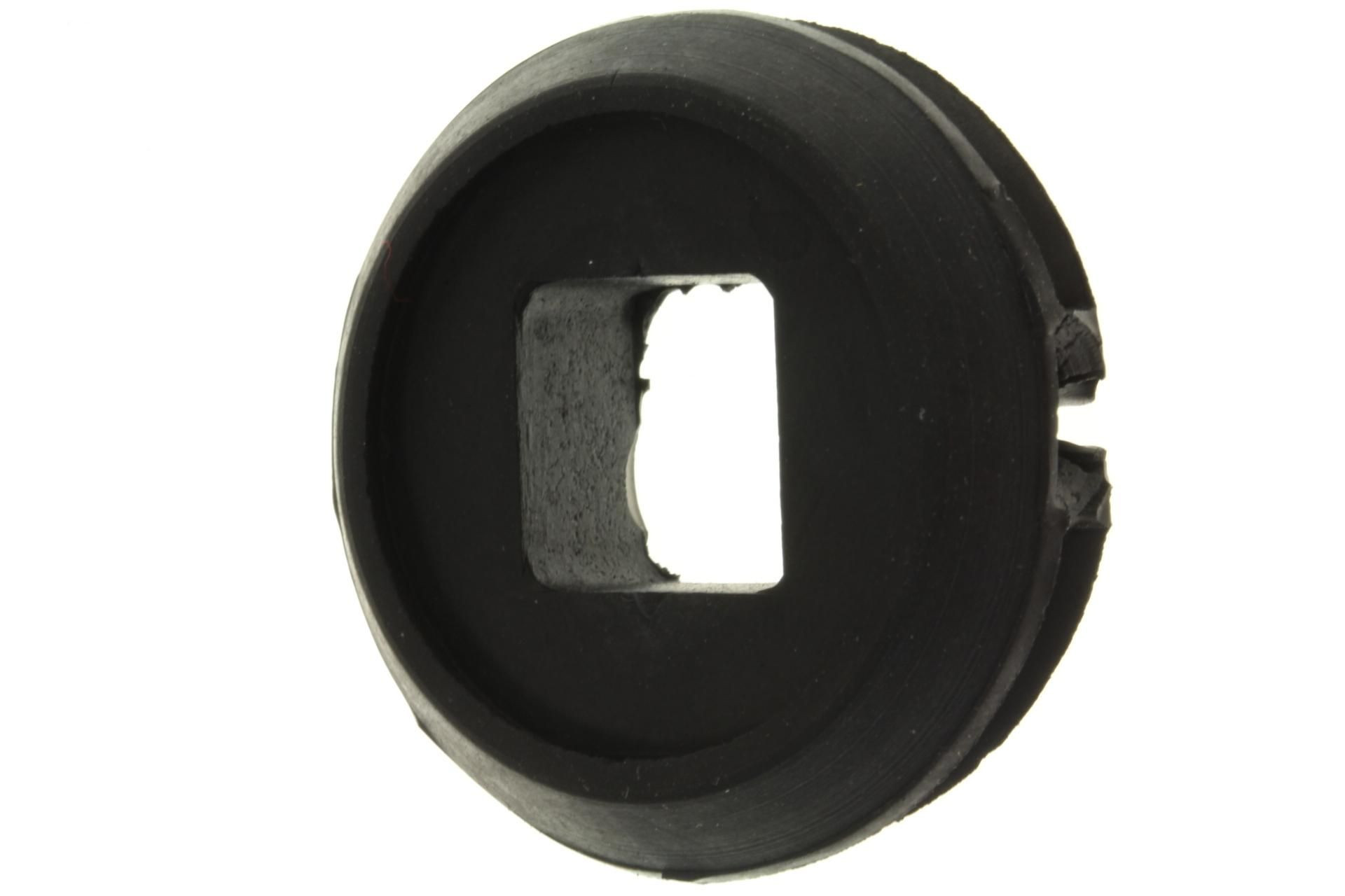

    • 1690
    This is the rubber bushing for the rear turn signals which I see you have. The is also a large flat washer and nut to tighten the parts together up underneath the bike.
    Click image for larger version  Name:	MTA3MjQxNTU-d5e8d735.jpg Views:	0 Size:	136.0 KB ID:	875034
