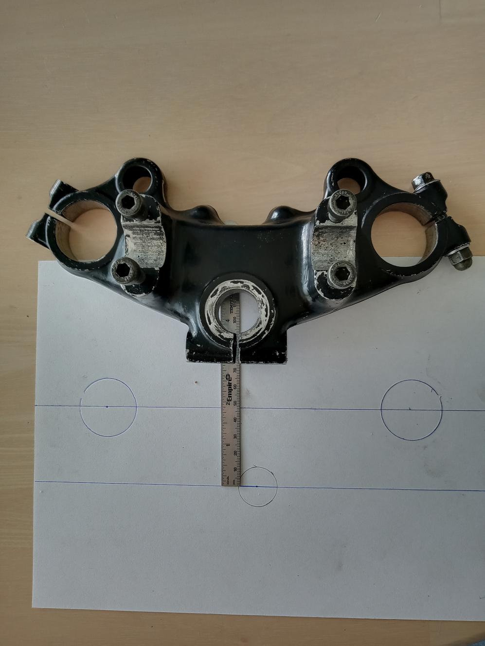

    anyone know the offset of both the standard and special yokes ? ive been searching for a while but not come up with owt !!!! my SF measures about 35mm by the way.

    This is the Standard...

    Looks like 47 or 48 MM.
    Sorry, I don't have a Special yoke off the bike to measure.

      nice one, thanks Phil looks like theirs about 10-12mm difference between them both. couldn't measure mine accurately as its still on the bike.

        I have both off the bike so I can measure them. But I'm not sure what measurement you want. I can measure the same way bikerPhil did if that's what your looking for?
          yep, perfect
            • 724
            OK, using Phil's method, I measure ~34mm on the special. and on the standard ~47mm. I'm not a metric guy but I think that is about the same as Phil's measurement..
              perfect cheers Ranger my guess of 35mm wasn't bad
