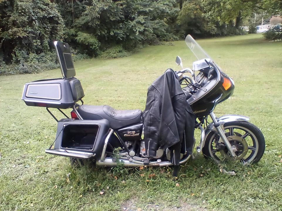

              Thanks for the responses. Yeah, We'll take it one step at a time. Here's a pic fresh out of the shed. A definite barn find.

                Finally got the keys for the XS. Looked in the tank and it's super clean. Tires are next then I can get her in the garage. I got the bags open and they're not too bad. The trunk and right bag need some fixing. Slowly but surely bringing her back to life.

                  • 7673
                  I'm riding a '79 that looks a lot like that! Mine didn't take that much to get it running, but I'm still playing with locks and keys for everything. The "750 final drive mod" is my next project, as the special, with the 16" rear tire, is geared too low for Idaho and the 80mph highway speeds.
