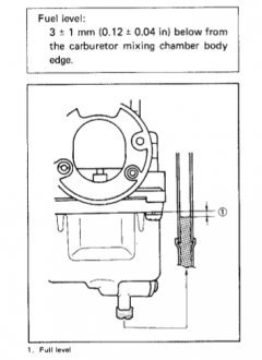

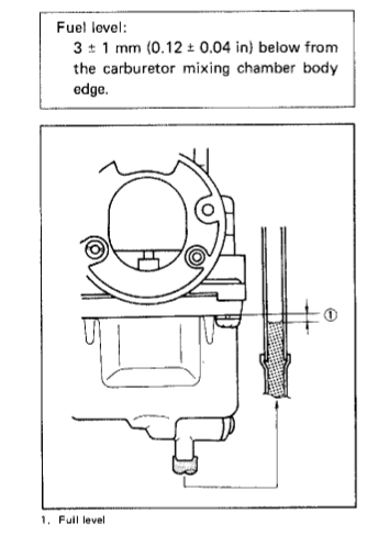

            what should the fuel height be in each bowl?
            For the 81-82's, should be the same for 80's with the plastic floats.
            Click image for larger version  Name:	81 fuel level.png Views:	0 Size:	47.1 KB ID:	866791

              Here's what I ended up doing.
              Based on research here and other places, the most important measurement seems to be fuel level in the bowl rather than float height. 23.5mm is where I set all the floats, which is only .5mm strong, and it did stop the fuel leak. And now I can put down the fire extinguisher when I start it up. (Though it's still close by.)
              The carb is back on the bike. I used my new carbtune to synch them, worked like a charm and evened out the idle (I'll add a video to my main thread).
              I'll use bikerphil (thanks!) info to check levels while carbs are on the bike. Is that data good for '80 Special? Nevermind, I see you updated the post - thanks!

                • 2103
                The ultimate goal is to reach the fuel level in Phil's post whilst the bike is running at idle, on the center stand, as level as possible.
                Also the carbs should be in synch and mixture screws set properly.
                These three tasks, once completed and rechecked will amaze you how smooth the bike will climb from 20mph in 5th gear to max speed without downshifting.
                  I remember that picture and the words in the FSM seem to be a contradiction.
                  I think the 3mm is supposed to be measured from the top of the bowl where it joins the top half of the carb.
                  When you measure 3mm down form the top of the bowl, the correct level is right at the bottom surface of the washer (the washer on the float bowl screw).
                  Anybody else remember this discussion? Please chime in.
                    • 2103
                    Yes Mike, I believe you're correct. That's where mine are set and the bike likes it
