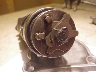

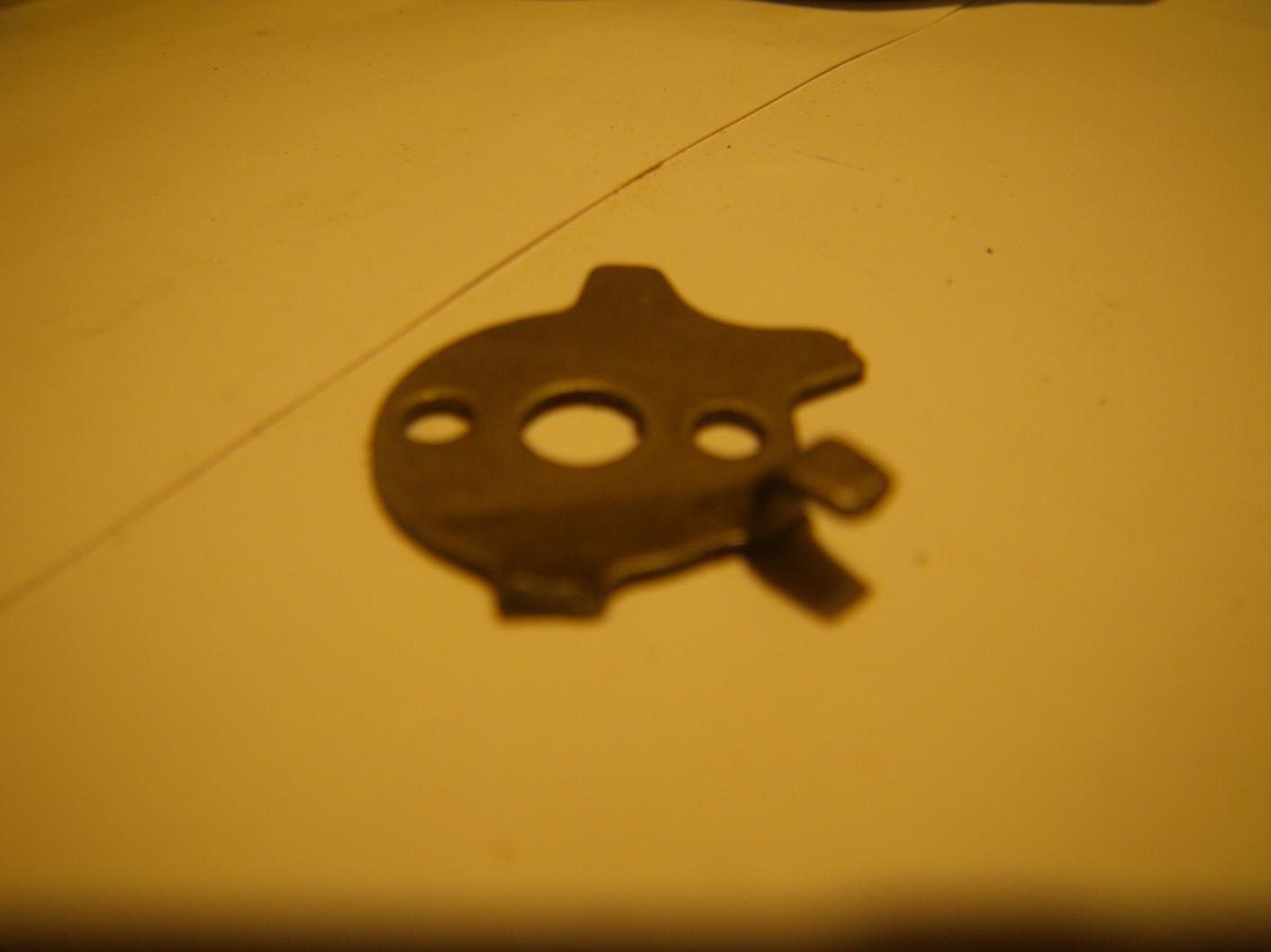

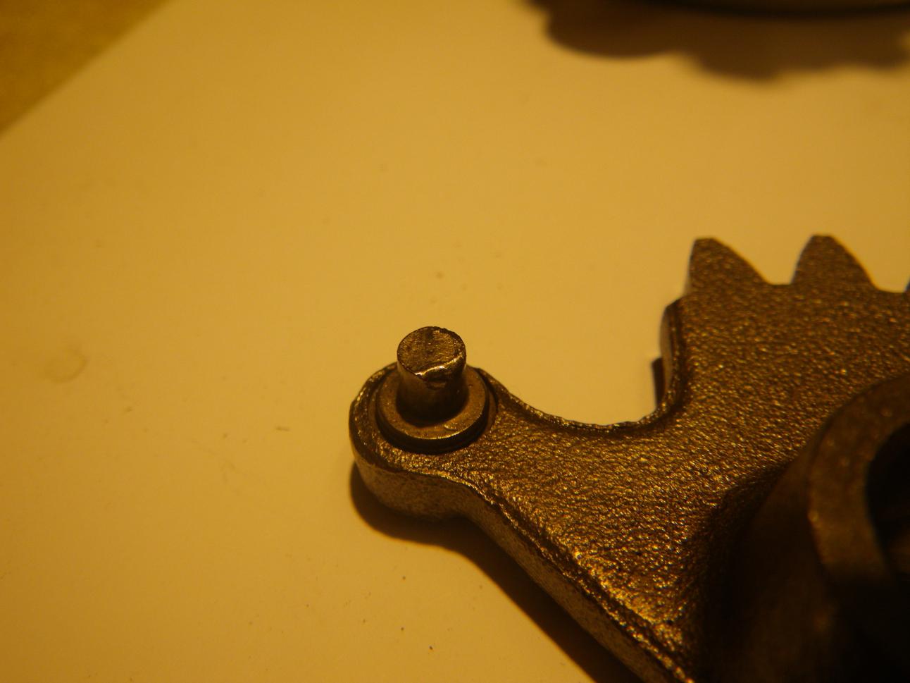

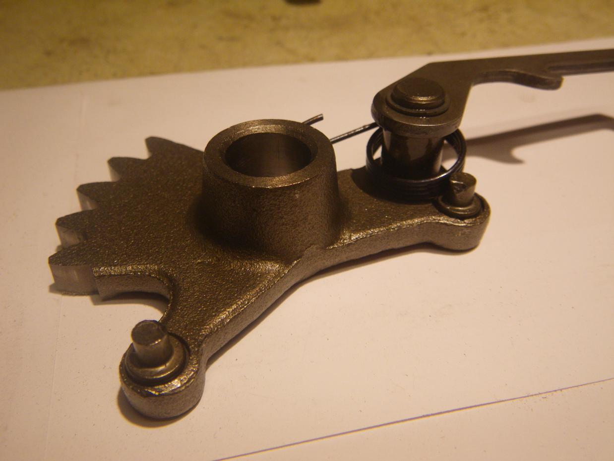

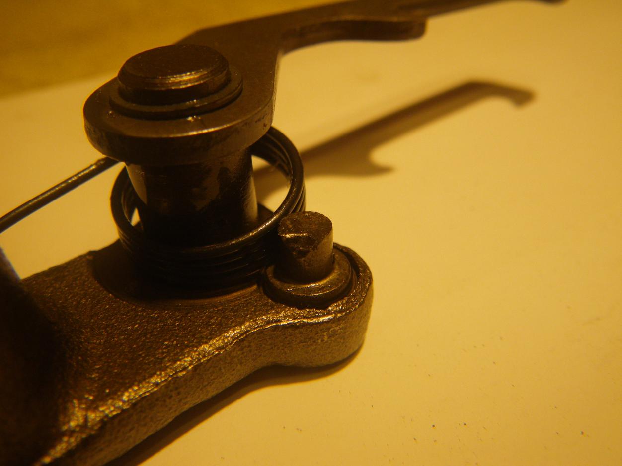

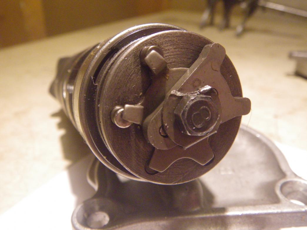

      Yes, can shift up. Shifter jammed and won't go down. Part of the work performed involved changing out the shifter shaft and shifter pawl/lever assembly with parts from the other transmission, so, unless they're both bent, that's not likely the cause. It seems the shift pawl/lever and the end of the shift drum do a very close dance every time I shift and sometimes they step on each others toes. Old parts taken out show contact between the throw limiter studs on the back of the shift/pawl lever and the star washer, so, silly me, I thought I had the problem licked by changing out the damaged parts. Apparently not. I've attached pix of the damaged parts for analysis.

        Very peculiar. It seems to be above my pay grade.
          I suggest checking correct attachment of shifter spring, with it having been preloaded before attaching hook retainer portion. As stated, check shift shaft for straightness.
            • 1879
            Make sure the bike is in 2nd gear before aligning the shift pawl marks.
