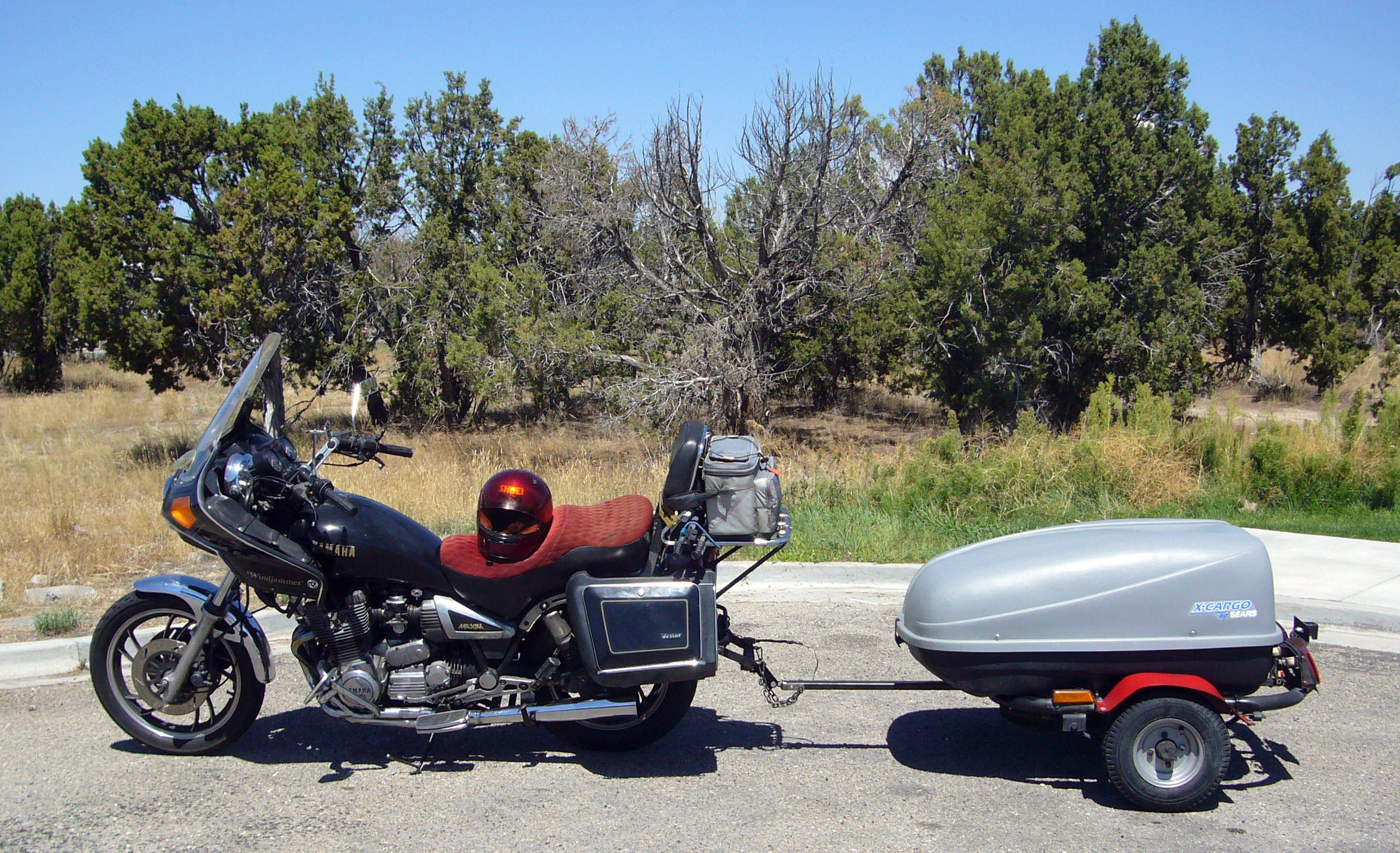

                    Like this:
                    My homebuilt trailer behind my XJ heading to a rally in Olympia, Washington in 2007. Also pull the same trailer behind my '06 Concours. Built in '99, I pulled the rig for 13 years, still have it but last two years I've stayed in hotels for the Brockville rally in '14 and this years rally in Michigan.
                    There are several threads about building trailers and hitches on this site. Do a search to look at some of them.
                    Some place I have a post about how I built mine - frame is tubular steel to save weight - and details on the XJ's hitch. The hitch for the Concours was a commercial product so I did not have to build one.
                    Jerry Fields
                    '82 XJ 'Sojourn'
                    '06 Concours
                    My Galleries Page.

                          Without going into the nitty-gritty details, ViperRon is correct on many points. However, a well-designed trailer and hitch is pretty safe to tow with an XS or XJ.
                          My trailer uses 230 pound capacity slipper springs, total capacity 460 pounds, and "dry" weight, with spare tire and jack plus car-top carrier, comes in around 120 pounds. Full loaded it comes in at around 180 pounds or just a bit more than carrying a passenger. It doesn't bounce around. This also keeps the weight under the XJ's GVW rating which I think is important if you do not plan to fit brakes to your trailer.
                          Hitch was designed so the drawbar is in line with the swing arm pivots when I am on the bike resulting in a towing force axis that is pretty low. Yes, you can feel the trailer pushing in corners, but no more so than riding double. I have never had a handling problem with this set-up.
                          One thing I will mention is that tongue weight is critical. To little and the trailer with fishtail. I ended up making a longer trailer tongue and mounting the spare tire on the front of the carrier instead of underneath, my original plan. A cooler was originally part of the original design which would have added some extra weight but it was soon removed and replaced with a small cooler I put on the XJ's luggage rack. (My original trailer tongue cracked under the weight of the cooler.) Most places suggest 15% - 20% of the over-all trailer weight be the tongue weight but I went a bit more, around 45 pounds on a 180 pound trailer with a full load of gear. Even at that I pack my heavy items in front of the trailer's axle. This works well for me, no problems with the trailer's handling empty or full, but it did take me a season to fine-tune this aspect of trailer design.
                          I do run a swivel hitch of my own design, build with 1/2 inch Heim ends. Hitch can rotate in 3 axis and does not bind in any situation. I went this route more from cost - cheaper to build - and curiosity but the choice of hitch is sort of like what oil is better...there is no definitive answer, although people on both sides hold strong opinions. Originally I used 3/8 inch Heim ends and one cracked so I went to the 1/2 inchers and have not had a problem since.
                          A trailer is an accessory and as such you need to look at the cost-benefit of puling one. it will cost you in reduced MPG, higher tire wear, and a difference in handling. The up side is that you can carry more comfort and convenience features, like a larger tent, camp stove, folding chair, air mattress, and other creature comforts. But if you decide to go this route, particularly with a home-built trailer, do your homework and research so you end up with a safe and roadworthy rig.
