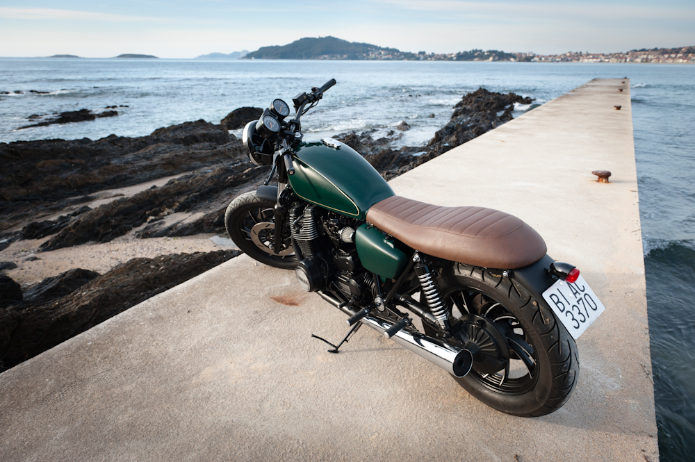

                      I like this one. Somebody explain how they got that seat over the fender, or is there no padding on the pillion?
                      I don't care for them fenderless.

                        Jet, my seat is like that. The fender is bolted to the seat. I like them fender less though.
