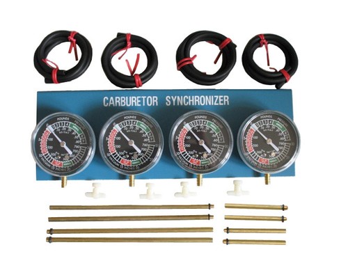

              The one I used and got poor results was exactly like what you have, THIS is what I use.

                That
                Is exactly what I just bought.
                I could have made up one of those liquid in tube gauges. I even have enough mercury switches that I could have scavenged the mercury from to use instead of colored water but having accurate analog gauges was more important.
                To me its just easier to read and faster.
