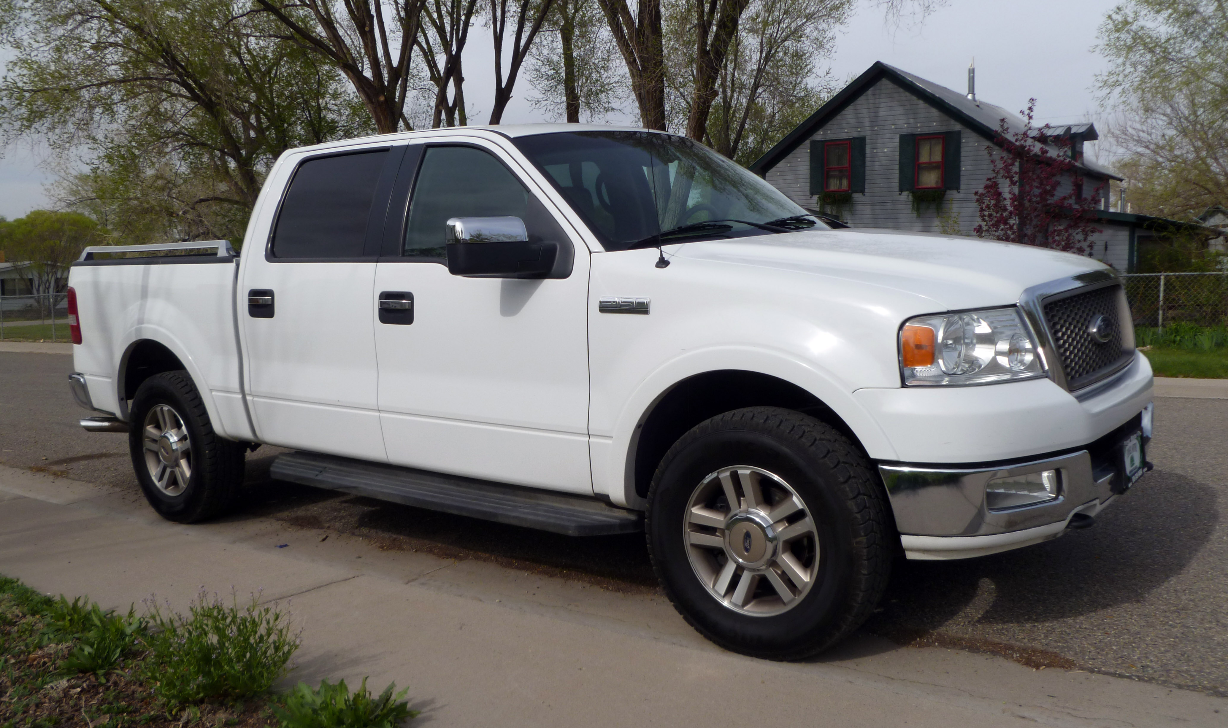

                              Just to close this thread...
                              I ended up with a 2005 Ford F150 Lariat. 5.4L V-8. Truck already had a cold air intake and cat-back dual exhaust. Still need to pick up a brake controller and equalizer hitch. Photo below:
                              Lariat package includes power / heated seats and upgraded interior. Seems to be very comfortable.
                              We will see how well it handles the 26 foot trailer, but other owners I have spoken to seem to think this combo will work well.
