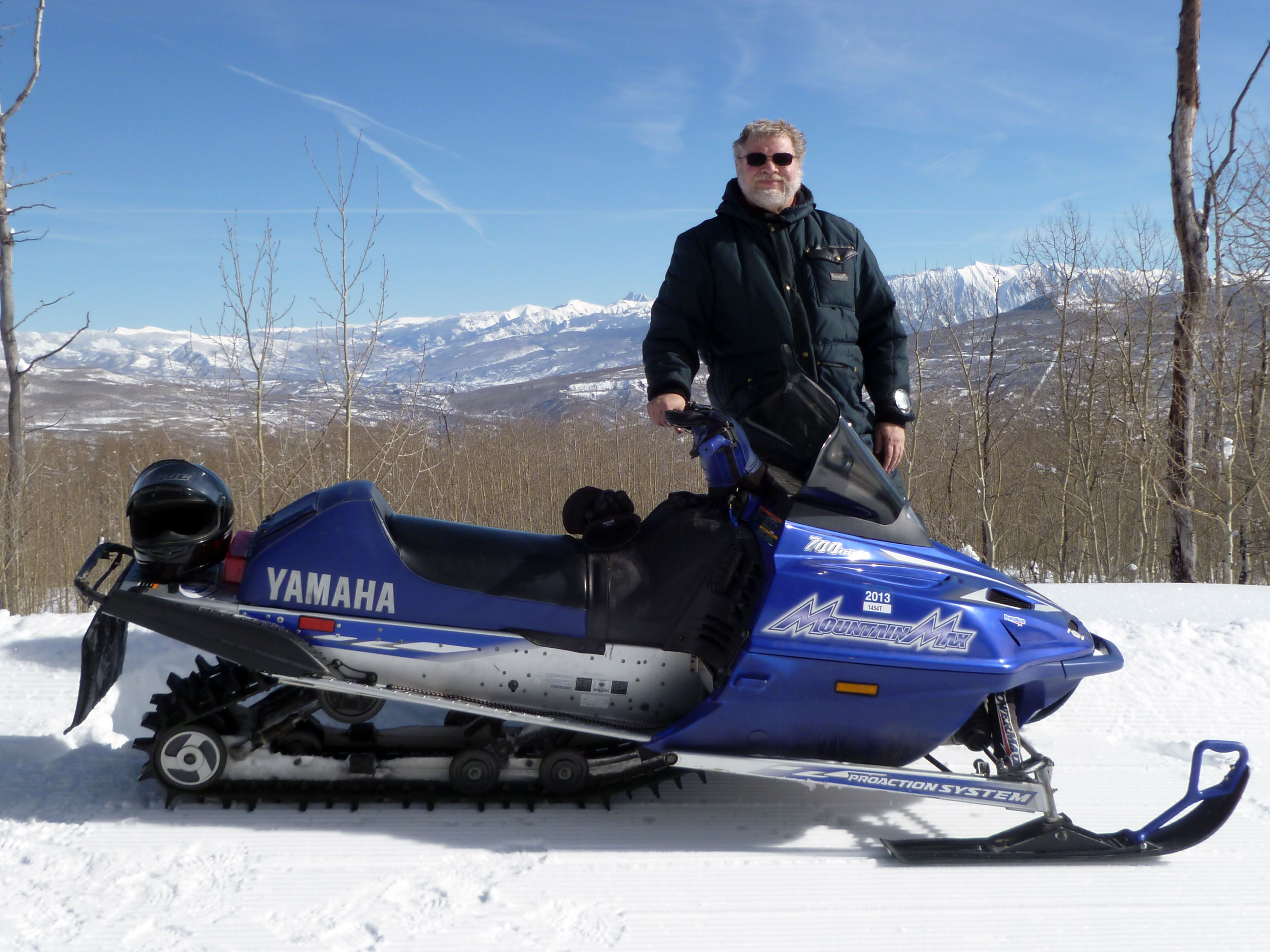

              Snowmobiling has been good out here in the west. I have had my 2001 Yamaha Mountain Max 700 tripple out a few times on Grand Mesa.

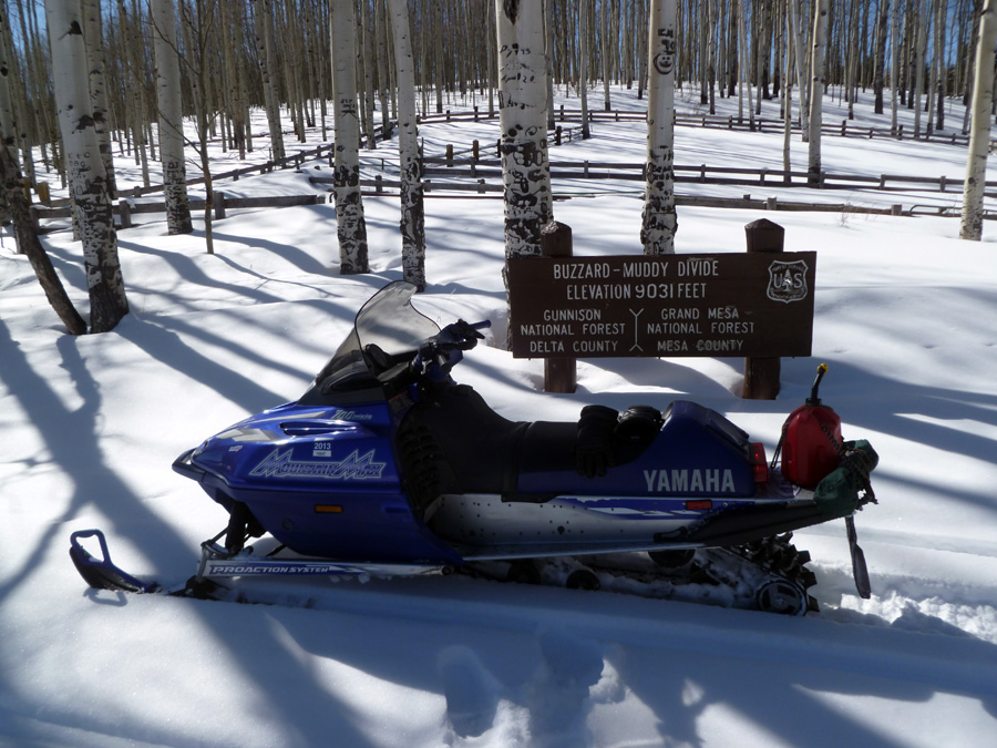

              This shot taken along Stevens Gulch. Elk Mountains in the background. I bought this sled last year and rode very little due to lack of snow - you need enought to cover the rocks - but that has not been a problem this year. We are still below normal for snow pack but hope to catch up by the end of the season. Another 1 - 2 feet have fallen on Grand Mesa since this picture was taken on 2-2-2013.
              Sled is stock except for a taller windshield and those grips at the front of the skies. They curve the tips up a little more sharply than the stock units. Front shocks also have PowerMadd covers on them. The 700 tripple puts out about 125 HP at sea level but up here at around 9K - 10K feet the output is down from that. Still, all I have to do is push the thumb throttle and go!
              Most riding is done with engine spinning in the 7K - 8K range, so if something goes wrong it doesn't take much time to do major damage.
              just so us couch potatoes can be properly thankful it wasn't us, how far back in the bush were you when it happened?
              Photo above is about 42 miles from where I parked but about 5 miles from the nearest parking area. Longest I have ever had to hike was 6 miles after my Arctic Cat blew a clutch. FWIW Yamaha mountain (long-track) sleds have a reputation for reliability that is unmatched by other brands, one of the reasons I have this Mountain Max. I have also owned Arctic Cat, Polaris, and Ski-doo. Yamahas are not the fatest sleds, but they will generally get you home every time.

                  Nice picture! I'd love to ride in the mountains like that. All my riding is done around 600' to 2500'. This years snow fall is isnt anything to brag about but its significantly better than last years. I didnt even register my sled last year thats how bad it was...
                  Nice sled, is that a 136"track track? It looks like it has a healthy lug on it. My sled is far from stock. Mine has a tunnel and rail extensions to make it a 136". It has a lot of other small stuff like bar risers, different seat, custom painted hood and decails from a RXL...

                    Factory stock 141" track. Lugs are about 2.25 inches, also stock. Most mountain sleds around here are running 151 - 168 inch tracks for the added flotation. Both previous sleds - Yamaha RX-1 and Arctic Cat Bearcat - had the longer tracks and 'floated" a bit better; the Mountain Max tends to tunnel a bit but will go thought a lot of deep powder as long as you keep moving.
