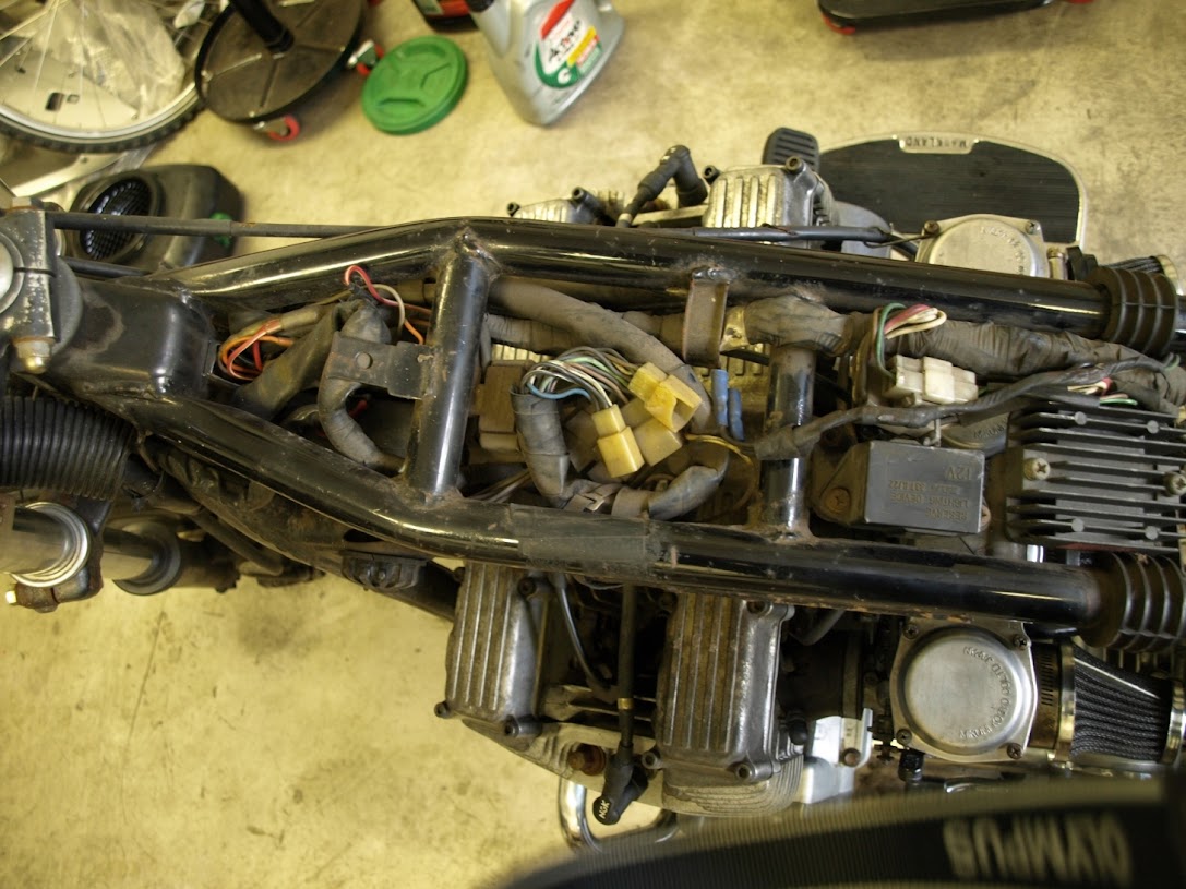

Hey there Andy,
I see that you figured out the photo posting process with your gas tank drawing. I've reposted the other photos from your album so folks can see them without having to leave the thread!
Okay, I can see the TCI/Black box just above and forward of the battery. You can follow the battery cable from the (+) terminal and you'll find the solenoid, I think it's been relocated just below the TCI inside the frame above the starter. If it's been starting, then you have a solenoid. Now as for the fuseblock.....it may have been eliminated
, but hopefully it's just been relocated as well???
The handlebars are the buckhorns...and you may find that they are not very comfortable...puts your wrists in an awkward position...most special owners have swapped them for more ergonomic ones.
As for the tires...you'll want to check their born on date....if more than 6 years old...replace...that front one looks like a pathetic cheap old bias style!
Lots of parts can be found used vs. new to save $$$. Those micro turn signals are a WASTE....too close together and too damn small....no body can see them....take a look at the MISC forum... the Yes, we are invisible thread, and you'll rethink the size and spacing of your brake/running and turn signals!!
There's more, but dinner's ready!
