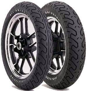

                              My mathbox says a 120/90-18 tire has a theoretical outside diameter of 26-1/2" and that a 130/90-16 tire has a theoretical OD of 26-1/4".
                              Fred did you use the equation out of your math book that says the width is 120MM times 90%=the hieghttimes 2 plus rim diameter=26-1/2"? I like the disclaimer "theoretical".
                              I have bridgestone spitfires, the 130 should be 5.11" but measures 5.4" which coincides with Bridgestones chart,
                              http://www.totalmotorcycle.com/photo...pitfireS11.htm
                              On this chart the 130/90 16 has a width of 5.4" and an overall diameter of 25.1" giving it a theoretical ratio of 84% (Does the ratio include the bead height maybe?)
                              They list a 120/90-18 at 26.7" and 5.0" which gives us 87%
                              At any rate the difference in circumference between the 18 and 16 by Bridgestone is just over 6%.
                              If one where to go with a 130/90-18 it would increase to 27.4" and 5.3" for 9%
                              Wouldn't you only be one inch higher with the 18 inch vs the 16 inch wheel? The distance (radius) from axle center to the edge of the rim would olny be one inch greater
                              Yes it would but I was using soccer4m's numbers being 24" and 28" in diameter----4"/2=2"
                              Lastly, after looking at a few different charts I have come to the conclusion that not all tires are created equal. Depending on manufacturer you can get a 130/90-16 at 5.1" wide up to just over 5.4" wide. I quess the numbers on the side are to be used as a guide only and the author assumes no responsibility for any errors or omissions contained therein
