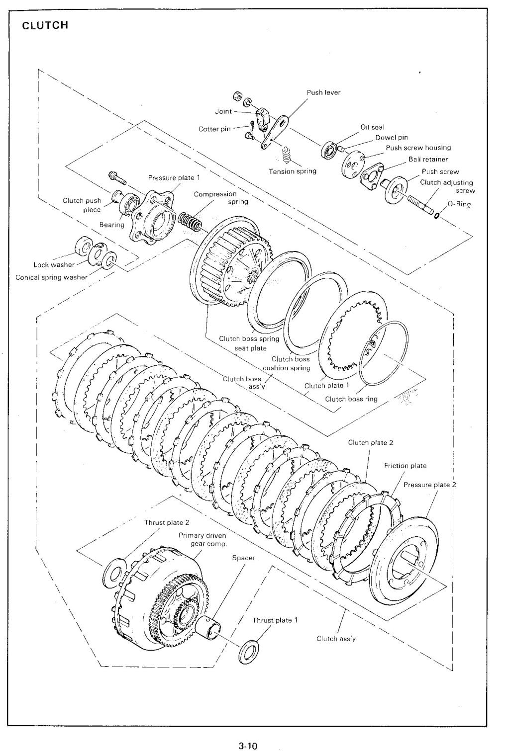

        Clutch diagram.
Name:	XS11 Clutch Diagram.jpg
          • 299
          I stand corrected, I did use the Vesrah springs, not the Barnett,,,,the pic reminded me of them,,,,anyway,,,tried the extra plate and it was too tight, so used the original steels and plates, cleaned them up, light sanding,,,,,,oiled and put in the Vesrah springs and it was like new. It was 20 years ago doing the clutch redo,,,,the star plate cracking of some members scared me back then so I picked up a few extra just in case,,,never needed them, just take your time tightening the bolts....keep us informed ,,,Mike in S.Diego,and PA.

            That is incorrect, the clutch case cover still needs to be removed to change the springs. The center clutch nut doesn't need to be removed, just the six star plate bolts.
            Right you are, total brain fart on my end. I just remember being glad not to have to go "deeper" when I did the springs, and my "hypothesis" of the clutch plates being just fine based on prior experience with my '78
