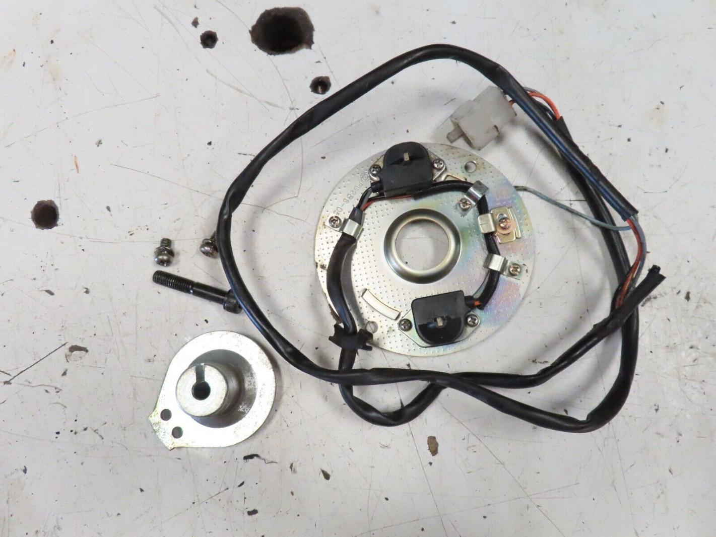

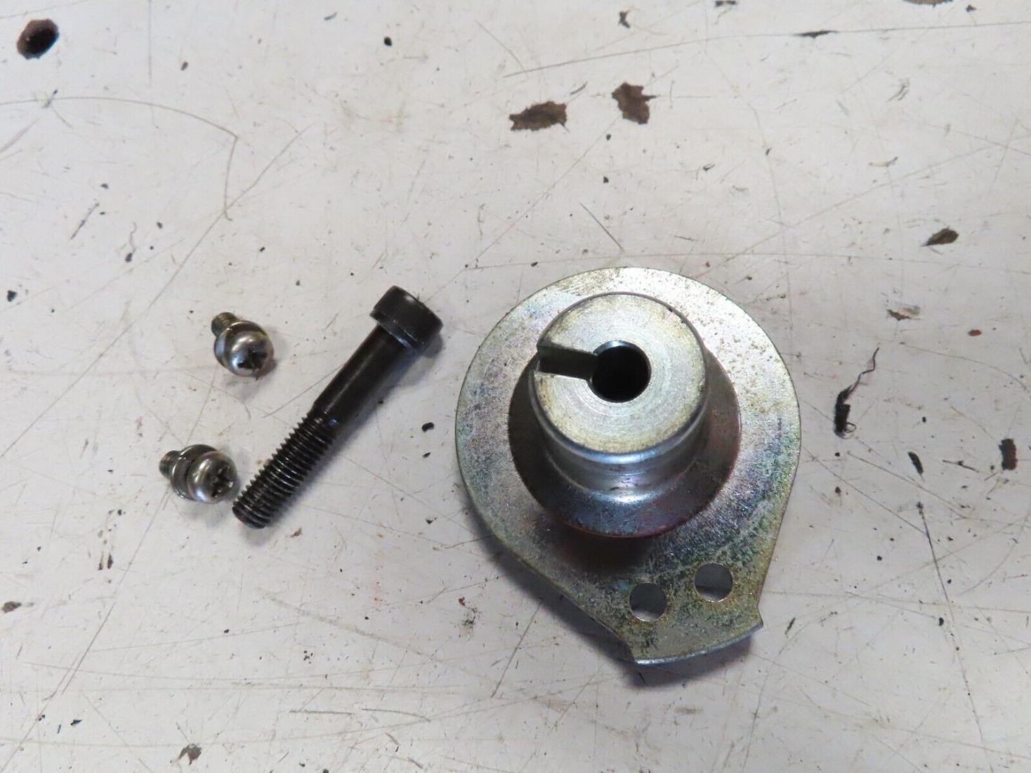

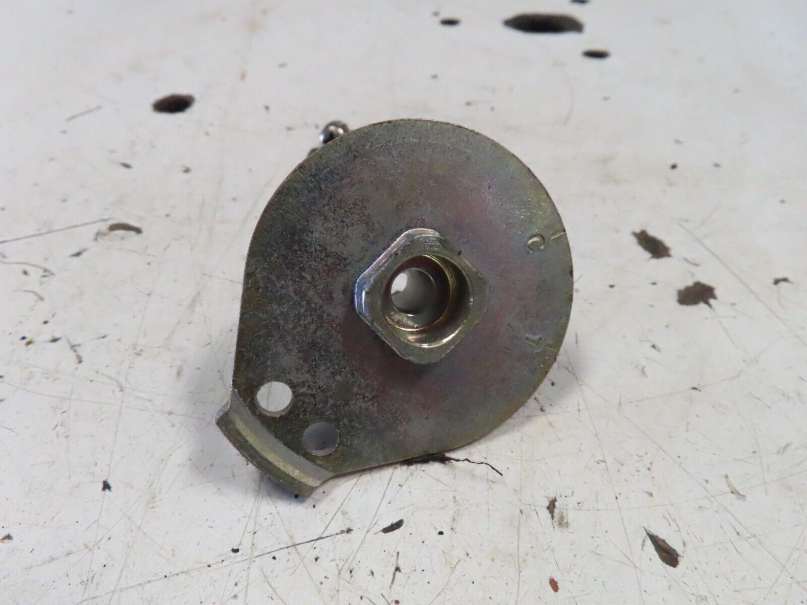

    Here's something I've had around for a couple of years but have always been leery of trying. I've HEARD that the XJ1100 ignition can be fitted to the XS engine to replace the moving pickup coils.
    Having to do all my work wherever I'm camped at, I've always been worried that something just plain won't work or a problem I didn't count on would pop up. This conversion requires drilling out the safety screws holding the timing plate and boy, if something didn't work and I had to go back to the old unit then getting everything lined back up right would be pretty daunting, at least for me back in the woods somewhere.
    It'll require moving at least one conductor inside the plug that goes into the TCI and reassigning a couple of wires in the wiring harness. The vacuum advance sensor will need to be mounted and wired as well but should be as easy as 3.14159.
    So anyhow, here's a snapshot of what I have. An 82 XJ1100 TCI, the pickup coils mounted on the timing plate, the proper commutator and the vacuum advance sensor. I've not personally tested any of these parts, they where eBay finds that I bought a couple of years back. I've got about $150 invested and would be happy to recoup it.
    • 2058

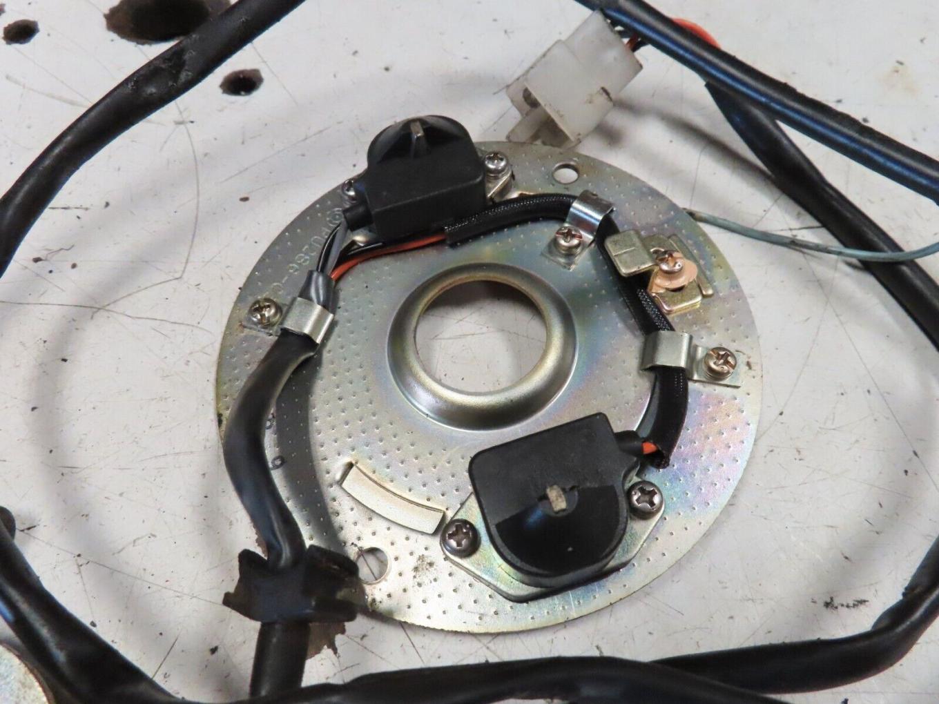

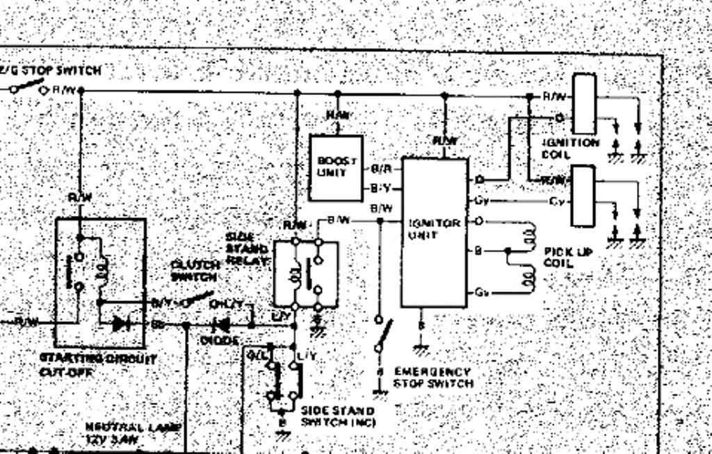

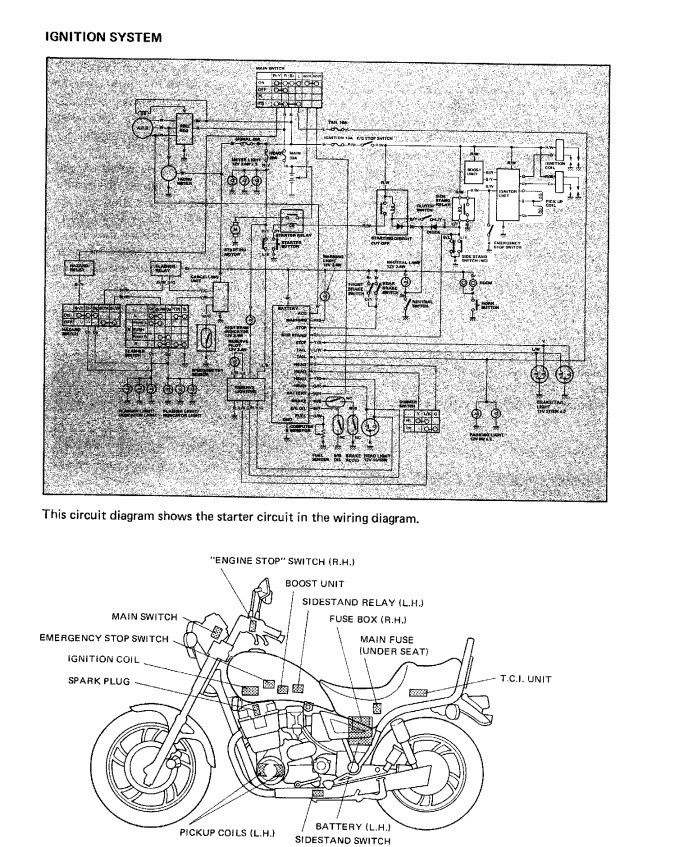

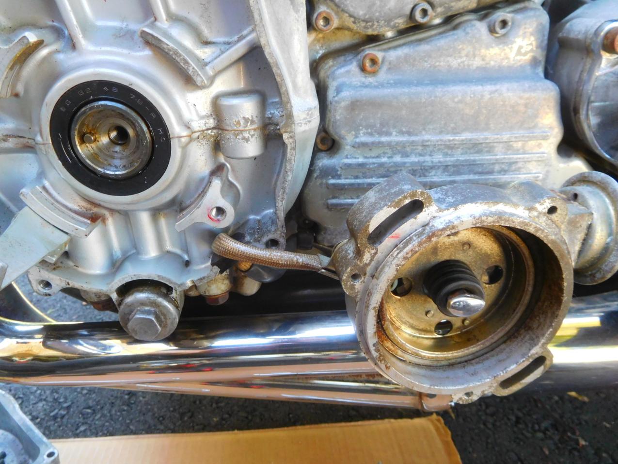

    Nice kit LAB3. The timing advance comes from the vacuum sensor which works very much like a Harley EVO advance unit. It has two time programs: retarded and advanced. Not linear like the original centrifugal advance unit but it does eliminate the broken wire issue. The hardest part of this install is making sure the wiring is perfect because you will get one chance to get it right or "Poof". However, it's not too complicated if you follow the wire schematic. I have drilled out the advance mount bolts on my bike and that is not too difficult. You replace the security bolts with cap screws.

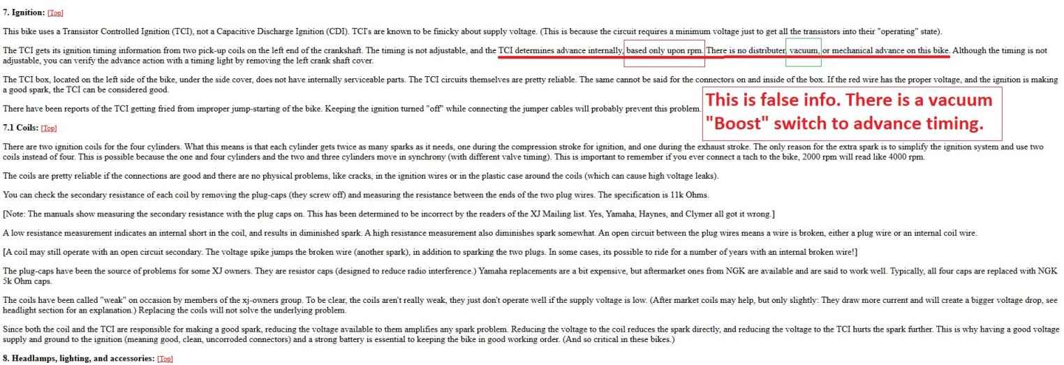

          Beware of false info on this device on the XJ4EVER web site. The author does not understand the equipment fully. The system certainly has a vacuum switch to advance the timing electronically when the RPM's increase.

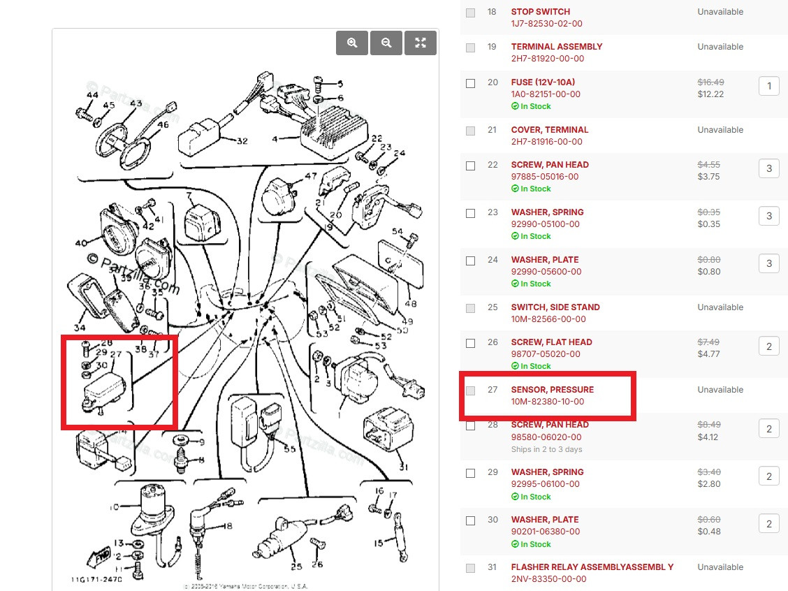

            Here is the "non-existent" vacuum advance switch. Very important part of the system. (LAB3 includes it in his kit.)

              I've got the pinouts for both the XS and XJ TCI unit wiring diagrams sketched out which I'll include. Basically there's one spot on both models that's left blank but they're different between the two models hence the need to swap out one wire on the TCI unit plug. I've never messed with doing anything like that which is why I shy'd away. A guy could cut the connector off and use individual off the shelf connectors for each pin. It's not a very complex task and given a better working situation such as a garage and a place to stay I'd do it. Then again, if I WAS set up that way I'd fix the second gear issue and broken exhaust studs and cylinder #2 then keep going down the road!
