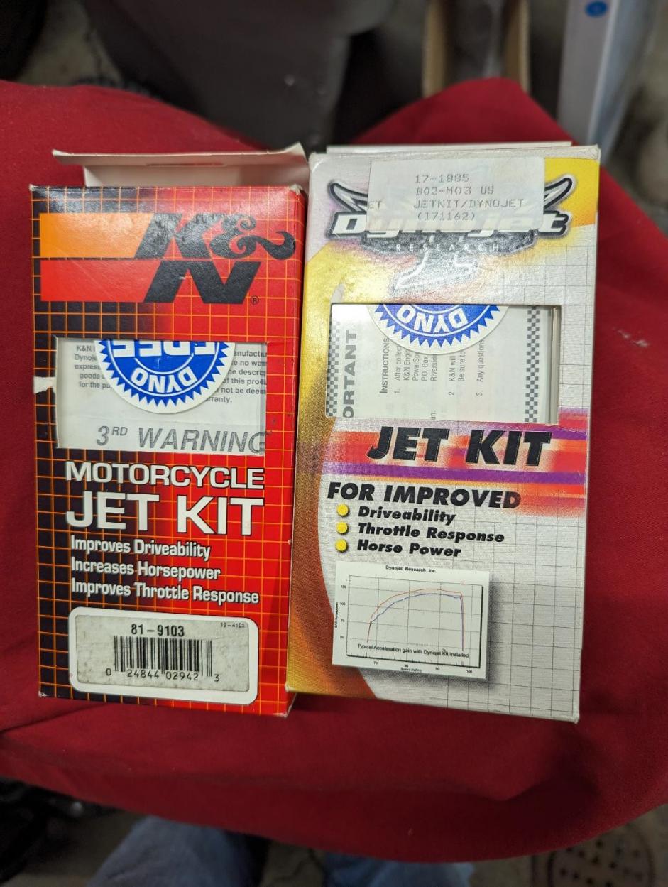

    Does anyone know anything about the DynaJet Carb kits? I don't... but I have 1 and 1/2 kits that I'll never use. The package says it is for 1980-1982 XS1100 and XJ1100 for stage one and stage three, whatever that is?. The contents of the full kit includes 16 jets and 4 needles. the partial kit has 12 jets and 4 needles.. Most of the pieces are new. A few have been used. Any interest here? If so, I can post more pics and the instruction sheets. Or pm if you like and we can come up with a fair price for them. Thanks.

    Oh... I guess it's DYNO JET... not DynaJet... just shows how much I know about them!
      • 2058
      Yes Ranger, I have installed several kits in all sorts of Japanese and American bikes. The different stages refer to the different states of engine air flow modification. Stage 1 is simple air filter flow modification such as a stock shaped K&N gauze air filter. The other higher stages refer to modifications that bring higher air flow through and engines such as high performance exhaust and individual pod air filters. Porting a head and hotter ignition are also considerations. When more air is introduced it makes the mixture leaner. A jet kit of any brand is used to calibrate the mixture ratio back to approx. 14.7:1 (1 part fuel to 14.7 parts air).
      That being said, the kit includes main jets and adjustable needles. The needles usually have a thinner diameter to flow more fuel at certain RPMs. This is important: DYNOJET HAS A PROPRIETARY JET NUMBER SYSTEM. In other words a Mikuni #130 and a Dynojet #130 are different sizes. Totally uncool for the next owner to figure out what is in his carbs if he assumes the jets are stock and tries to modify. However, the dead give-away are the needles with adjustment clips. Beware.
      Do they work? Yes, if installed correctly and calibrated correctly. Usually the smallest jet in the kit and the needle clip set at #3 position will give good initial results. I do not drill the CV slide anymore because it ruins the drivability on the street. Yes, the slide comes up fast for "drag racing" but it also flops back down too fast and makes the carbs very fussy.
