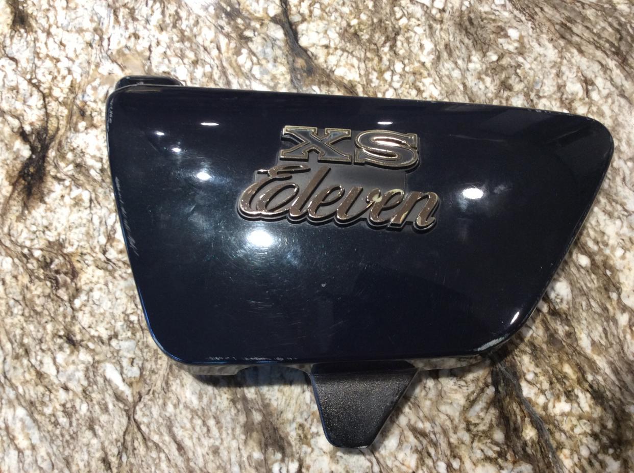

      I can hardly believe it but look what I found! It was sitting up nice and pretty about a foot from the side of the road! Just a few scuffs but miraculously no real damage whatsoever. You can’t believe how happy I am. It was about a 60 mile ride that I took yesterday and it could have been anywhere but fortunately it was only about 4 miles from home. Now to come up with a better solution than the PO had done.

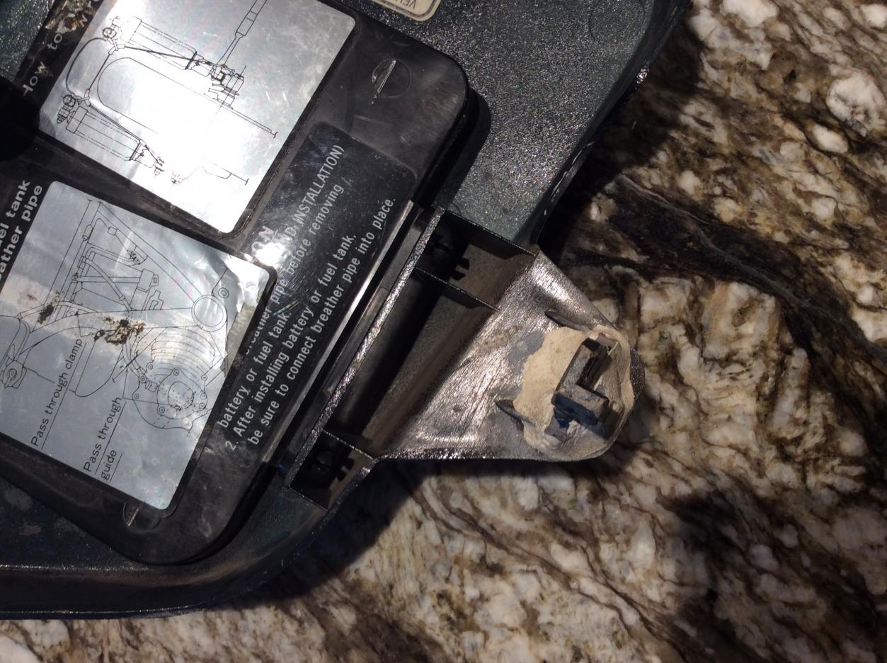

            You can build up the broken tab with baking soda and super glue then file it to shape. check youtube. It makes a nice strong repair. Glad you found it!
            1979 XS1100 Special
            1980 XS1100 Std parts bucket
            1987 ZL1000 Eliminator
              • 1984
              I would get some of this to build the tab up if necessary.

                    Is that a metal tab that was fabricated to repair the side cover? My eyes might be fooling me but it does look like sanded metal. If it is you might want to consider this to completed the repair. Side Cover Repair Kit for all Yamaha XS1100 | eBay
                    • BBQRider
                      • Sep 2017
                      • 51
                      • Asheville, NC
                      That looks like a great option Cajun. I wish I had seen this earlier because I probably would have done it that way. I came up with another solution that probably doesn’t look as professional but seems to work pretty well. I’ll add some pics in the next day or two.
