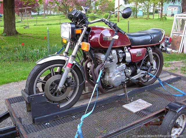

    New to the board!! just found it searching on info on the XS1100.
    Also, new to the XS1100, I Just picked this 1100 up as listed on Craigslist (Above link) last night!
    I Just got the license plate/insurance at lunch and going to get plugs, brake fluid, carb cleaner, etc...Needs a bit of TLC, but seems to run pretty good!! Original Owners manual, warranty card, tool kit, and a rear rest/rack (not shown).
    Has the Kerker 4 into 1, a bit loud for my taste..but will find a stock or quieter muffler as needed.
    Thanks!
    Dave

      congrats!!
      03mach1,
      That's a sharp looking E. Congrats on the find, and welcome to the forum. Just about anything you need to know can be found here. The search bar is your friend.
      Word of advice- the left hand side cover has a locking tab that you need to unlock with the ignition key. Don't just pull; you'll break off the tab. Then when you try to take it for a ride anyhow, it'll get blown off. DAMHIK...

          Nice looking 'E there, 03. About the only thing that comes to mind at first glance is the bent choke lever. This tells me you'll need to take apart and clean up that assembly when you strip the carbs down for their first of their 'triple clean".
          Ken Talbot

              The kerker CAN be quiet for a while. They are a "glass pack", and just need to pull the baffle and replace the packing. Mine has been getting louder over the past month, so it will be getting a "new coat" for summer.
              If you think you will be riding in the rain, check into drilling the front rotors. The life you save by being able to STOP may be your own!
              Welcome to the site, and NICE BIKE!

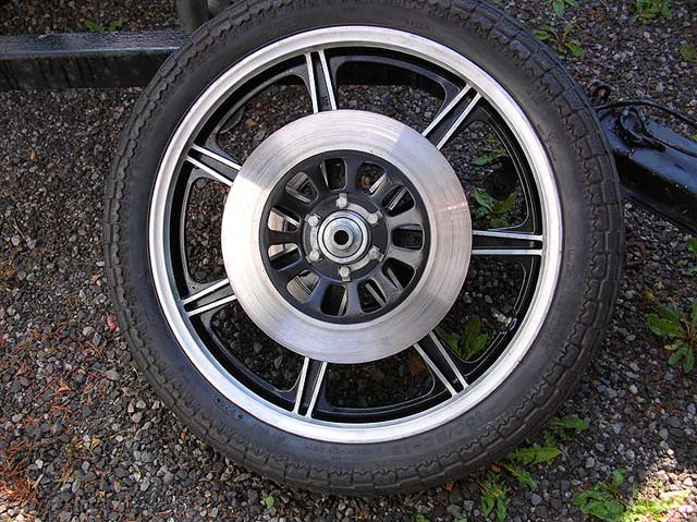

                    Removed Front Wheel, rotor centers are all cleaned, wheel is polished and black re-painted, looks brand new now.
                    Put the rack back on the back, need to paint up the headers/pipe & change oil. New plugs are in. Brake pads should be here Tuesday to put the front end back together.....

                        Front Wheel after polishing and painting, alot of elbow grease and mothers mag wheel polish.

                          OOOOH, Purdy!
