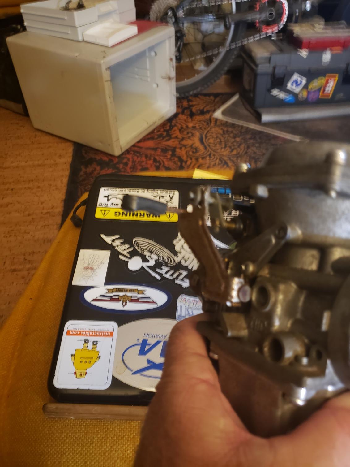

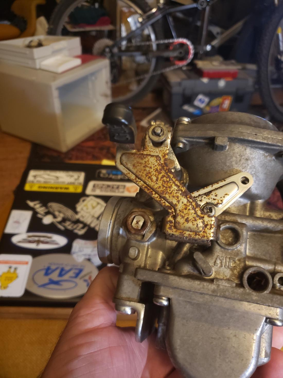

    I have not addressed this problem yet, but I think it is time to take action. My Choke Lever (Leftside of Carbs) is in very poor condition, it is badly rusted and has been bent over at a 90 degree angle, possibly more than once, I see indications of fatigue cracks developing and have not risked trying to straighten it. Before I rebuilt the carbs, the choke linkage was very sticky, prolly the cause of the bent lever. Since rebuild the lever functions fine.
    As for condition of a replacement unit, I am cool with slight rust as long as it is not pitting. I will prolly end up painting the lever. My carbs are the early 78-79 units.
    Fingers Crossed.

    Two locations where enricher shaft goes through carbs housing there are detents on the shaft where a metal ball and spring are located. A drop of oil in each of those locations will resolve the bending of the control arm.

      Yes, When I rebuilt the carbs, a long time ago, I cleaned up all the areas where the shaft slides, and put light oil on them. even now the shaft moves just fine. The Lever is in really bad shape, it is very close to breaking off. There are obvious cracks developing in the bend, I am sure it will snap off if I try to bend it back. Then I will have two pieces to keep track of, till I can fix it. If there is no replacement available then I will prolly bend it back straight, if it doesn't snap in the process, and hit it with some gas-shielded high voltage, maybe even add a doubler to buttress the joint.

            That arm can be saved. Take it off then disassemble it. Find you a small piece of like metal.... I have been purchasing 650 carb choke arms off of Ebay primarily for the rubber choke arm end piece. However, the metal it is made out of is perfect for repair work on existing choke arms. If you don't weld take it to someone that does, preferably a friend and just tac the repair piece on the inside of the arm. When you resassemble, paint or powdercoat you won't be able to notice the repair and it is stronger then original. I have done several that way with great success. The metal is just thick enough to be able to weld it with a mig setup. I always sandblast the entire piece before starting.

              Yes, that prolly will be my solutionto the problem, I do gas shielded high voltage work. LOL I am leaning more towards the better than original concept, as well.
              My LG that I had back in the 90s suffered from a weak lever as well, all the linkage was fine just the lever would flex, rather disconcerting. I would put my thumb down the inside of the lever, and use it to push from lower down inside the lever.
