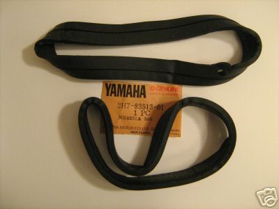

    Hello all,
    I am in the need for 2 meter damper for an 79xs100f. Thanks for your help
    Damper, Meter (2H7-83513-00)
    1979 xs 11 Standard

    for spedo and tac
    sorry better disc. it is the gasket that seals the spedo and tac to the meter base.--

      Good luck, they've been discontinued for a long time. I used rubber edging channel, got it from a rubber supplier on Canal St. in NYC. IIRC, Canal Rubber. They are on the web. Fused the ends together with contact cement. Looks great and has held up for so far 4 years. BTW, cut the ends on an angle to help hide the seam and to give it a larger contact area for strength.

        I think there might be some info on this in the tech tips section, done by TC a few years ago with weatherstrip from HomeDespot
